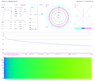

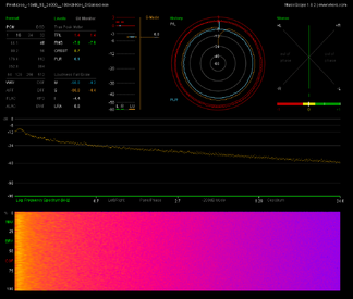

I should probably add some explanation to the files I did upload.
The tool shows the TRUE intersample peaks (TPL), so POSITIVE levels ABOVE full scale may occur !
The tool uses a RMS scale most of us may NOT use. I use a 'sinus peak level equivalent RMS value' giving the same number measuring sinus for peak dBFS and RMS dbFS . The tool uses (which may be physically precise) 0 dBFS for the max level of a square wave. Please add 3 dB (substract 3 dB from the absolute value).
The high rise at the bass end is due to a scale compression (NOT exactly log.). The REW pink noise shows a steady falling line which is perfect.
The -12 dB pink noise measures -14.6 --> -11.6 dB RMS, which is o.k. THE peak level shows a headroom of 0.8 dB. any higher level tahn -11.2 dB will show compression.
The 'black' pic shows a 1.4 dB overload and a wrong RMS level. This is the BUG. level should be -10 dB ( musiscope should show -13 dB FS RMS ) but is -7.9 , more than 5 dB too high.
I use a bandpass filtered pink noise to improve the quality of the loudspeaker sensitivity figure.
As of now I experiment with 125 Hz to 6k3 at different filter slopes and using periodic noise.
1 kHz sinus gives quite bad figures. The REW 500--2k Noise is a BIG improvement. But I like a little more influence of the tweeter and teh woofer, but NOT the UPPER and LOWER END.
The 'musiscope' by www.xivero.com analyses loudness according to the new standards.
-akl-
7,311
OK, think I understand now. There is a bug that the level of custom filtered pink noise is affected by the low and high cut filter frequencies even if the filters are disabled. I have fixed that for the next beta release.
