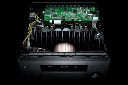

Today being "Boxing Day" up in Canada (this tends to be the best day to go shopping for the best deals in A/V here) I came across an Onkyo RZ810 for $900 off the regular price at Bestbuy. My wife by my side says to me "seeing as you have worked so hard on renovating the basement storage/laundry room, you can buy this for the Theater room" on top of that she says "let's buy some Home theater seating while we are at it" Of course I asked if she was sure but long story short we have a new receiver and seats for 7 (3 in the front row and 4 in the back) pictures to follow once they are delivered.
NOTE: Update, I ended up returning this unit and upgrading to a RZ 920 as the 810 only had the option of processing either 7.2 channels or 5.2 with 2 Atmos channels. Where the 920 has processing for 9.2 channels.
The 810 has everything I need and clames to have 130watts per ch although I'm scepticle of that but it's not small and has a nice size tordodal power supply up front and has compleatly separate analog amplification and digital processing blocks as well as solid copper bus bars to limit interference. Non-phase-shift amp circuits shift the frequency roll-off point higher than the listening level, and combined with Onkyo new AccuReflex technology that works alongside its proprietary auto EQ room correction.
While on the topic of auto room EQ I've been thinking a lot and there is some aknowlagment in the industry that EQ above 400hz if applied unevenly between left and right channels can cause the image to collapse and I've exsperimented with it and found this to be true. Onkyo has gone this route and may be turning heads away but I'm in the club that it may be a good thing to leave the front soundstage alone or at the very least do it externally using REW as a tool and outboard EQ and amps as I already do.
Anyhow Atmos here I come...now just to redo the ceiling of the theater room and install some speakers.
