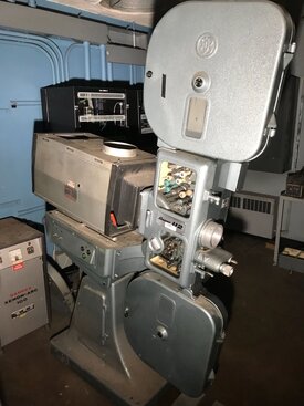

So I have the opportunity to get my hands on an old German Bauer U2 70mm theater projector for free. Its rather large (about 5ft tall with the reels on it) and weighs about 600lbs and is currently sitting in an abandoned theater that the company I work for owns. You may remember I took photos of it a year ago and posted them on the old forum.
So, I guess the question would be is if you had the opportunity to have one in your theater room would you clean one up and put it as a showpiece? Im just not sure where I could put it in my theater that would not be in the way.

Wow, that is one huge projector. 5 ft and 600lbs. Wow..You would need a big space to occupy that projector.

The footprint is only about 16" wide by 36" long I have an area to the side I could stuff it into I think

Thanks for the info, I had no plans of restoring it to function just as a side piece for discussion only. Just not sure if it's worth the hassle of getting it home and set up.
The projectors were set up as A/B roll one would end and the other would start. I watched Starwars in that very theater along with many other blockbuster movies like Star Trek, Jurassic Park and so on.

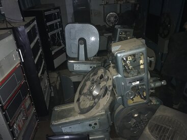

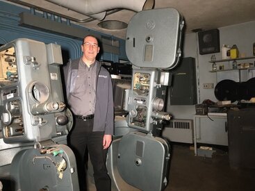

Well, after alot of thought Ive decided to not try and take the projector home as its just way to difficult to get out of the projection room. Im sure they weigh over 1000lbs so I assembled one of them as best I could and took the below pictures and I will just print the photos and frame them (much lighter) LOL
Kind of sad really as Im moving jobs within a couple weeks so wont have access to the theater any more.
Took some 70mm reels and other odds and ends from the concession stand including a menu board with pricing that I will use at the concession I build into my theater at some point.

Nice pictures. Wow, they are huge..

Ya, I worked in a downtown mall years ago that had a 12 screen theater on the top level and often went into the projection room (a long hallway that connected all the theaters) they used a platter system for the film so they could run the film through two or even three theaters at once if it was a big blockbuster at a time using a series of rollers along the walls to carry the film from one projector to another.
Those were similar projectors to the ones above
