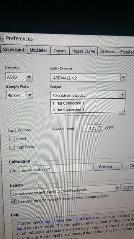

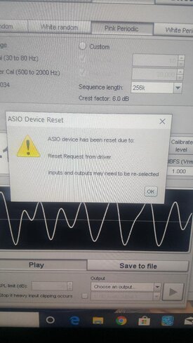

Everything worked fine yesterday and now I get "output-not connected" "asio has been reset". How and what should I attempt to do?

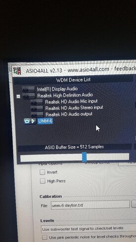

There isn't any output selection in ASIO4All, only the UMM-6 is selected. If you are using the HDMI output then you should select the "Intel display audio" device in the ASIO4All control panel, then click Reload on the REW soundcard preferences.

I ended up uninstalling all and going through the setup guide, basically starting over. Think it was ultimately an issue with ASIO and I think the mic cal file was an issue as well.
It was just strange that everything worked fine one day ago.
All is working again.
