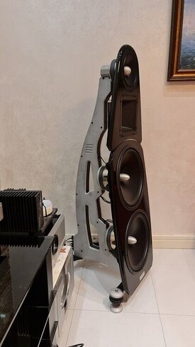

No sub. An open baffle three way. I've attached the photo of the speaker in question here. Not sure what channels he has mapped. He seems to know how to use AL so I am just looking at his cfg files to instruct him how to map the info into HQP.
