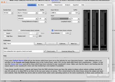

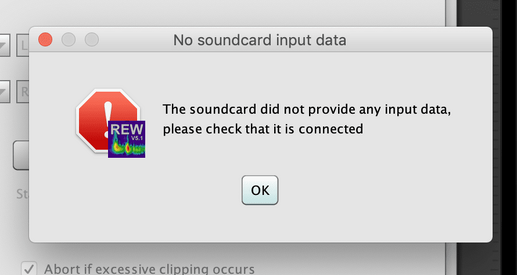

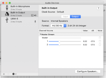

I am a new user and could not find information on my problem elsewhere so am hoping someone can help me with this. I am using a Dayton Audio UMM-6 and a MacOS Mojave 10.14.6. I have Audio Midi set up to use the UMM-6 and in REW Preferences have selected the UMM-6 as the Input Device and Microphone as the Device. Under Security & Privacy REW is enabled. Any time I try to take a measurement I get a message that says No Soundcard Input Data, "The soundcard did not provide any inout data. Please check that it is connected." The UMM-6 is plugged in and blue light on. Am I missing something or can someone offer a suggestion? Thanks.

I have a similar set up, but I use a Scarlett Solo interface with ADAM AX3 monitors. I get a Ref IN but the IN is very low -97 dBFS... The solution is probably obvious but I can't find it.Thanks!
3,180
If you are seeing the mic signal on the ref channel you probably need to swap the input channel in the REW soundcard preferences.
