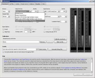

I got an error when selecting the line input of the Behringer USB sound card:
An error has occurred
Message:
java.lang.IllegalArgumentException: Mixer not supported: Line (USB AUDIO CODEC), version Unknown Version
Message:
Java doesn't seem to like that interface for some reason. Could try a different sample rate, otherwise there might be some issue with the soundcard drivers.

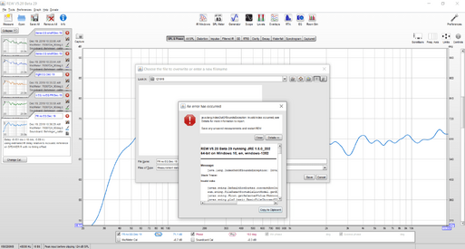

I encountered an issue trying to save a measurement, after exporting EQ and biquads.
Code:
REW V5.20 Beta 29 running JRE 1.8.0_202 64-bit on Windows 10, en, windows-1252
Message:
    java.lang.IndexOutOfBoundsException: Invalid index
That's actually an error in the Java runtime rather than in REW. Do you remember exactly what you did just before the error? Looks like it might have been some action with the mouse?
fackamato
Aug 5, 2017
8
I had just taken a measurement, went to EQ, created an EQ, exported biquad, then clicked to do another measurement. Nothing crashed, I could click away the dialog and continue. No other issue seen.

Hi, John.
I just installed the new 64-bit version after a long use of 5.19 beta 8.
I'm missing ASIO options in the Preferences menu which allowed me to measure 7 speakers separately.
Am I missing something?
