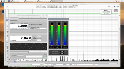

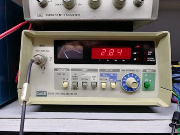

A fantastic job has been done on REW's latest RC7 release. The level meter works really very well, to test it I send two photos on the level measured at the output to the power amplifier with a true Rms voltmeter of the HP indicating 2.84Vrms and the level measured by REW after having performed the calibration on the generator and on the level measured in input by the RTA function. As you can see both the generator and the level meter that RTA measure the same voltage level.

Thanks so much John

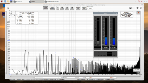

I have carried out other tests on the level of the measured signal and actually the measurements have a good accuracy from the maximum level of the output signal to the power amplifier equal to 8.9 Vrms to the minimum signal of about 10mVrms below this minimum level is affected by noise.
But it is precisely on the noise level I have some doubts, in fact by turning off the generator the RTA shows a much lower noise level than that measured by the FLUKE 8920A and the Picoscope.
The noise measurement is 28mVrms with the Fluke and Picoscope while REW measures three different values, the level meter displays 2.35mV the noise in the 430uV distortion box and the level measured by RTA 951uV.
The noise level measured by RTA should be reported to the highest peak at 47-48Khz the noise level of the distortion box should be much higher because it includes the noise generated on the entire audio band, instead it is only 430uV. The only higher value is that of the level meter but we are well below the 28mV around -20db.

The N (noise and non-harmonic distortion) figure in the distortion box is for the span to 45.6 kHz, as shown in the box. Distortion data ignores content above 95% of the Nyquist limit to exclude artefacts around Nyquist even if the distortion LP is not selected. The RTA levels panel uses the same upper limit as the distortion panel, which arguably it shouldn't if the distortion LP is not selected. Both exclude DC.
The levels meter is showing the rms value of blocks of audio samples, for a 96 kHz sample rate those blocks are 16k samples long.
7,314
The higher values on Fluke and picoScope are probably due to content above 48 kHz.

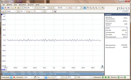

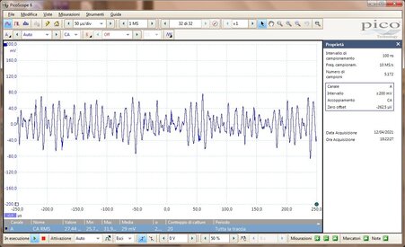

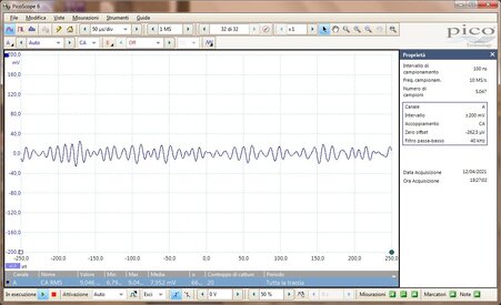

I did further tests to check the noise level measured by the system. I confirm that the lower level measured by REW compared to the Fluke 8920 and the Picoscope are due to the bandwidth that with the sound card is limited to less than 48Khz while for measuring instruments they do not have this limit.
I set the Picoscope oscilloscope's input filter to 40Khz and actually the noise drops to about 8mV, even higher than that indicated by the REW level meter.
But not happy, I measured the actual cutoff frequency of the oscilloscope and I found a frequency of 55Khz, so I verified that the actual Cutoff frequency at 40Khz corresponded to the picoscope setting at 29Khz.
I took the measurements again and this time the noise level of the picoscope decreased to 2.9mV very close to the noise measured by REW.
I confirm that the REW noise measurement is in line with that measured by Fluke and Picoscope taking into account the audio band limit to comply with the Nyquist sampling theorem.
Unfortunately, I trusted the accuracy of the Picoscope filter and instead the wrong cutoff frequency distorted the measurement.

No problem, thanks for the detailed follow-up. I have changed the way the main RTA level figure is calculated when the distortion LP is not in use so that it includes the full bandwidth and should read the same as the Levels meter.
