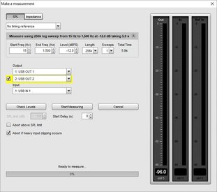

If I run REW on my laptop using a UA Apollo duo interface, I can route the sweep signals and signal generator to outputs 3 & 4 simultaneously, and patch channel 4 into input 2 for the loopback signal.
However, when I use my studio computer, which has over 96 channels of I/O, I can only access individual outputs, and even when linking the channels in the interface software they do not appear as pairs.
This means I cannot send the sweep signal to both of the outputs required for making measurements.
It would be very nice if the loopback signal source was also selectable individually.
At the moment there is a drop-down menu for a "timing reference output", but this does not send the signal generator to that output .
7,296
The output selected as timing reference is the one used for the loopback signal output.

Interesting, it does not output any signal when using the MOTU or Universal Audio Converters...
7,296
Have you selected the timing reference setting as loopback? I assume you are using ASIO, If you just want to send the signal to a second channel then check the box just below the main output on the Measure dialog and select the second output there.

Thanks for the reply John..!
I should have specified that I am in OSX 10.13.6
Ok I can see what I did wrong, I had not selected "use loopback as a timing reference" in the drop down menu in the measurement dialog window.
This was not completely obvious as I was setting up the measurements since this parameter only appears in the measurement dialog window., do you think it should also be in the preferences window?
I don't know why it defaulted to "no timing reference" though.
