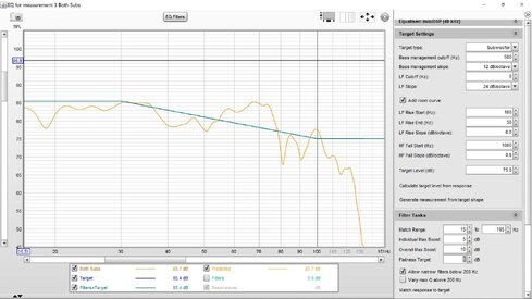

REW software is awesome. Enjoying the experience learning how to use it.
I have managed to get a good setting for my 2 x SVS PB4000 and now want to EQ my mains and integrate them with the subs.
See attachment showing the settings that I used to Eq the subs, I searched the internet and found these settings as recommended by the Home Theater Gamer
I have not been able to find a recommendation for EQ settings for my mains and would appreciate any advice or suggested settings.

The graph is not showing EQ settings (I assume you mean by that, EQ filters?), just the sub’s frequency response measurement (presumably after EQ).
There is no such thing as “recommended” EQ settings for the main speakers. That would be determined by frequency response measurements, from which parametric EQ settings could be ascertained, if needed.
It’s really not a job that should be undertaken by a novice because it’s easy to screw up. For most people, it’s best to simply use your AVR’s processor’s auto-EQ feature.

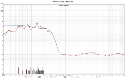

@pidge ask a question I always wanted to ask. My receiver gieve me the possibility to manually set 10 filters for each channels. I have a minidsp 2x4hd for the sub only. I choosed a harman curve kind of for the sub and tried the the same for the mains and surround.
Instead of that do you suggest to EQ the sub as flat as possible and do not EQ the main when set to small with a xo of 80Hz?

I’ve never been a proponent of “one size fits all” curves like the Harman. The ideal curve varies from one room to the next and is primarily determined by room size and your distance from the speakers.
You can certainly start by EQing the sub flat. However, if you feel the lowest notes are lacking, then try a house curve. You can do a search to find an article I did on the subject posted on another forum.
