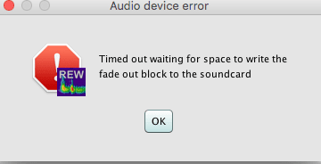

Hello John,
I am under High Sierra OSX 10.13.6, REW last version and build, 5.20 Beta 15.
I have created a multi output device but REW give me back this message:
Just for information, multi output devices never worked on REW, but works on some other software.
Thank you,
Best regards.

I'm presuming you are seeing the message when you turn off the signal generator? It may be safe to ignore it.

Yes the message appear whe I turn off the generator.

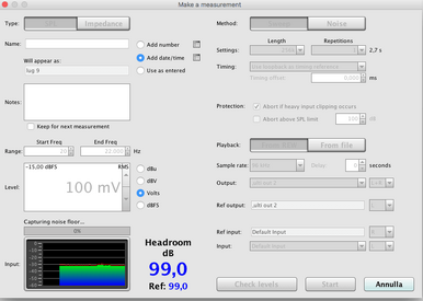

If I make a sweep measurement the generator get stuck:
7,310
There might be an error message in the log files from the sweep measurement attempt, they are in the REW folder in ~/Library/Logs. I'm not sure how I could go about fixing this though.
