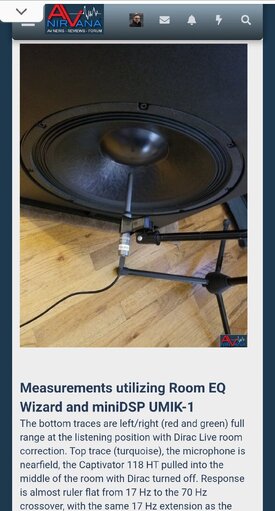

You guys are completely wrong. When I gain-match my subs, or when I want to do a near-field sub measurement, I place the mic on the tripod , which allows the tip of the mic to be right in front of the dust cap. Sure, I could use the boom mic stand if I rotated the boom 180 degrees so the mic is close to the ground, but the little tripod is so much more convenient. I guess none of you do these types of measurements...
I've done near-field, but I have two boom mic stands, so I use the other one, which is setup for that. Never thought about the small tripod, but it would work.
From my review of the JTR Speakers Captivator 118HT
