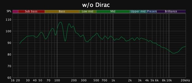

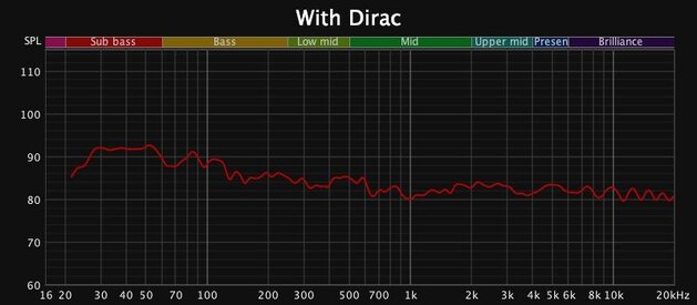

Do you have Dirac installed? I also have the Minidsp Flex w/Dirac in my small office listening room (10’x11’ w/vaulted ceiling’s 8’-10’). This is definitely Not an ideal room, but I’m able to get pretty good results.
I initially was planning on using 2 subwoofers (SVS 3000 micros), but since I only have “1” chair I was able to just use (1) subwoofer. I just moved the sub to the area with the best response and let Dirac do it’s thing. Then I eq to my specific taste.
In a larger room, 2 subs definitely help even out the low frequency, but in a smaller room with 1 listening position 1 sub worked. You may want to try just 1 sub if you only have 1 listening position also.

Due to room modes in a small room, with a huge null in the listening position, I use 2 subwoofers (rear L and rear R) in addition to the front L and R monitors. This does a good job of evening out the low end.

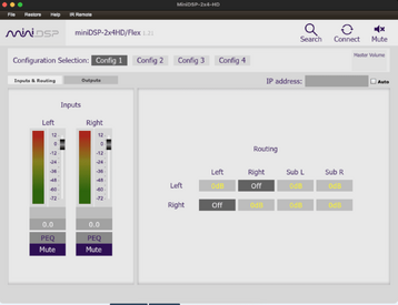

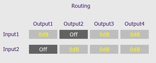

1. Try setting the two subwoofers to mono, see image.
2. If REW has UMIK-1 selected, the other default settings should work.
Arnold
View attachment 55388 View attachment 55389

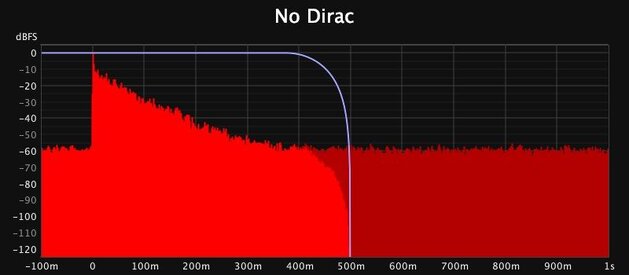

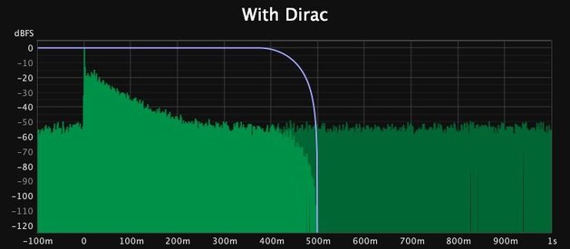

Can you produce the step response before and after Dirac? preferably speakers and subs combined.
I‘m pretty new to using REW, miniDSP Flex and Dirac so I hope the attached impulse graphs what you are looking for.

If this is the impulse tab in rew then change dBFS to % and in the control (gear on the top right) tick "plot response normalized" then you need to zoom in on the peak. You can see Mitch audiolense walk through to see how it should look like.
