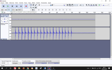

The problem - when I use the external audio card with the mic in the USB line input and make a recording in Audacity everything goes well, but when I connect to REW to use the multichannel HDMI output, ASIO recognizes the input and output ports but I get error messages like: you are not connected! See the figure below for the ASIO configuration! It shows that it is activated, in REW only “Capture” appears. What am I doing wrong?

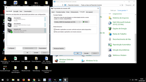

Yes the parameterization of 48k 16bits are the same at the input and output of the USB and Windows card. I think the card I'm using should not provide the USB mic streamer protocol, it only transmits the standard CD audio protocol, Audacity understands this protocol - REW no, am I correct ?!

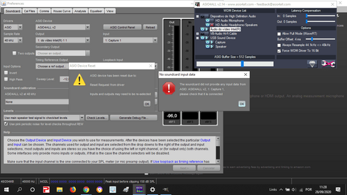

Thank you John for answering me. The flexASIO does not load in the REW, always the error that it was not possible to load the drive. I installed flexASIO twice already but the problem persists ... When using JAVA it is possible to select the USB IN line mic ports but it is not possible to do the calibration because there is a high signal in the IN input even without plugging the microphone.

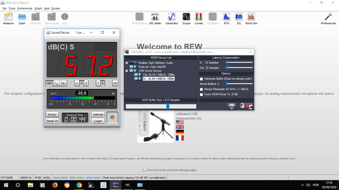

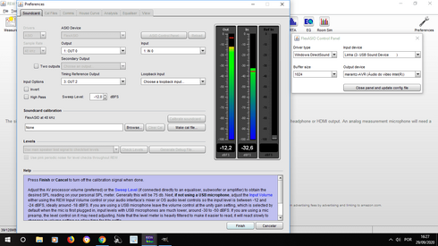

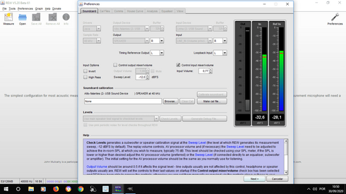

Hi John! I changed my computer and am now able to open flexASIO. But the problems of input levels still persist ... I'm sending some tels of configurations of the USB + MIC + REW card and debug file to be able to evaluate what I'm missing.

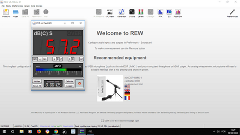

What is strange now that when I do the calibration in the first step a signal already appears in the IN of -36dBFS and remains constant there - only if resetting the USB mic input disappears or closing the mic! which makes no sense to leave the mic closed, right! REW recommends leaving the mic open until you adjust 75dB SPL vol mic + Marantz vol.
Another strange thing that happens when I calibrate Marantz with REW when I open SPL meter without clicking on anything is already there -36dBFS fig Cal3 and fig Cal7. I can't get the REW + card + HDMI + Line USB to work ... when I use java everything goes well on the windows card but the problems are repeated when I use the USB card for JAVA and ASIO .. I think this USB card to use popular sold on Amazon does not serve for REW measurements ... I ask if Behringer has anything that works with REW or has nothing to do with the problem I am pointing out? Thanks John for your attention and promptness ... these answers will help me make a decision on a miniDSP reseller in Brazil ...

7,212
That card appears to have a very noisy mic input. You didn't mention what your analog mic is, but it would be best to use an analog mic that accepts standard 48 V phantom power or a USB mic.

Hi John! when I record the card + mic as I show in the Audacity file everything is fine! No noise note that the gain in this case is 100% open with a little background noise but nothing that compromises. What's weird is using the USB card always has a kind of signal loopback that I can't identify in the signal path on REW and HDMI! This signal is equal to the volume of the mic adjusted in windows, if I take the vol everything is calm but on the other hand I am without mic for the measurements. I switched PCs with W10 as I said, solved the flexASIO problem that did not run but the signal feedback persists in the REW IN.

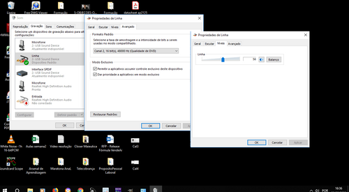

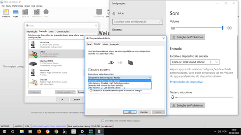

Do not use the soundcard Mic in for the line level signal from your mic, use the Line in.
Make sure "Listen to this device" is not selected in the Windows audio properties, Listen tab for the line input.

I always used the line input on the board for the mic, I also had no listening feedback on windows. Redefine the measurement, see the windows configuration in fig Cal8 and the REW response when I start the calibration, a signal appears at the IN input. I did another experiment, I removed the mic from the board and the signal is still there, I restarted REW and the signal is there in the background. (figCal9) Then I changed flexAsio for all types of driver - MME - Windows WASAPI - Windows Direct Sound - Windows WDM-KS and selected the inputs / outputs consistent with the use of HDMI and IN USB line, in all of them I always had the background ... the level changed because I changed the input gain of the USB IN line seen by windows.
The last fig Cal10 is the JAVA with the mic without USB card working normally with the level of the room captured by the mic - showing that everything is normal. Sorry to insist, I would appreciate your help making REW run on HDMI. Remembering that the card with mic in the USB line input when used in Audacity with MME drive works well, without noise that compromises the recording.

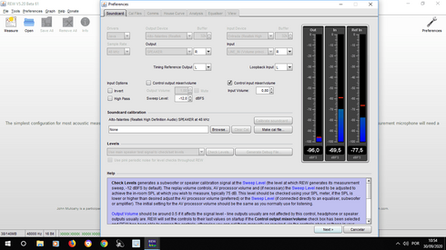

REW cannot create input signal on your soundcard. If the signal is only there when the card is producing output then either the card has some monitoring capability that is active or it has very high internal crosstalk. If it is there when the card is not producing output there must be some other source, but the source is not REW. Perhaps looking at the spectrum of the input signal would provide some clues.

Hi John! I made a few more attempts to understand why my LINEARX mic is not recognized by REW / ASIO. I replaced the Chinese USB card with an old SB0270 soundblaster card from a friend who lent it to me for the test. I also exchanged my HP Latitude E6410 notebook for an HP Vostro.
First conclusion - the Chinese USB card does not work on REW / ASIO on both notebooks. I discarded the card for use with REW.

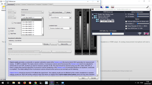

DEAR PRABA! NÃO POSSO RESOLVER ISSO. ESTOU COM IN / OUT 48K / 16BIT NA PLACA EXTERNA USB E TAMBÉM NO SOM DO WINDOWS. NEM ASIO NEM FLEX ASIO EXECUTA O REW HDMI.
35647
Sacenti
Jul 2, 2017
59
DEAR PRABA! I CANNOT SOLVE THIS. I HAVE IN / OUT 48K / 16BIT ON THE USB EXTERNAL BOARD AND ALSO ON THE WINDOWS SOUND. NOR ASIO NOR FLEX ASIO RUN HDMI REW.
