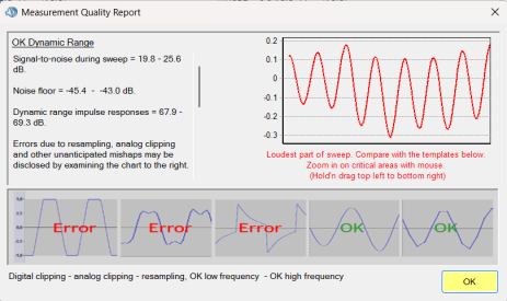

Newbie here but no matter how I measure, I seem to be getting this. My setup includes DPA4060 Mic connected to a USBPre2 ASIO on a PC. Guidance is appreciated please. Not facing issues on REW, Smaart.
