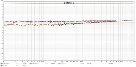

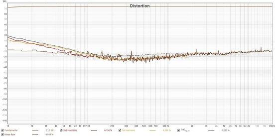

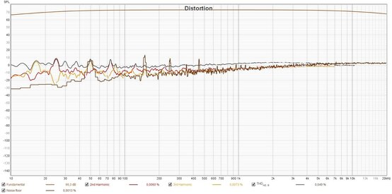

Apart from the frequency response REW-measurements show me THD and noise floor. I tried to measure to crosstalk between the two stereo channels, by setting the left output for the sweep but looping the right output to the measuring input.
However I am not sure if this makes sense. What is the right way to setup to make it comparable?
And I don't now what to look for. And I don't know how to read or interpret the THD-charts.

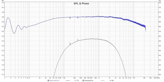

Btw: I calibrate the interface by looping output to input. Then I want to verify my calibration. But the frequency response is not flat? Why? However it is repeatable always the same curve with every other measurement.

Pretty odd result for that Mackie measurement. Main thing to look out for is any monitoring being active, that will mess up the measurements. For accurate measurements of soundcard distortion best using stepped sine measurements, but it is very slow. You can compare the THD results on the Overlay window, Distortion graph. Lower is better, but connections between measurements and subjective perceptions are elusive unless the measurements are very bad.
You mean the "Mackie verify.jpg"?

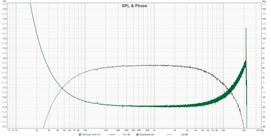

The "Behringer verify" (attached) looks similarly odd.
Is something wrong with my calibration?

Easier to tell if you post an mdat of a measurement. That is a highly zoomed in measurement, the whole span is only 1.2 dB, but it will be easier to check an mdat. In your Analysis preferences make sure the option to "Truncate IR after 1.7 s" is selected in Impulse Response calculation to help keep the file size manageable, can also select the "Allow 96 PPO log spacing" option for smaller files.
That looks like a C Weighted Curve. I doubt very much if any of these interfaces will have anomalies big enough to be noticeable in numbers.

The Behringer has a relatively high level of 2nd harmonic distortion at around 0.07%.
The "Presonus verify" and "Mackie verify" 96 kHz measurements are using soundcard cal files called "Presonus 44.1.cal" and "Mackie 44.1.cal" respectively, the cal files must be generated at the sample rate that will be used for measurement. A 44.1k cal file only has data to 22.05 kHz and the soundcard responses are different at different sample rates.
Something is wrong with the Mackie's settings, it is rolling off very early, already -3 dB at 13 kHz.
