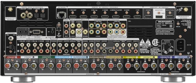

Hi all,
I have a question concerning a 9.1 setup which does not seem to be working anymore.
It seems that my setup stopped functioning after I switched my power bar off and on again after some cleanup...thought it was worth mentioning...
My setup was the following:
1X Sony SSCS8 connected to CENTER
1X Sony SACS9 connected to SUBWOOFER 1
2X Sony SSCS3 Front speakers connected to FRONT R and FRONT L
2X Sony SSCS3 Surround Back speakers connected to SURROUND R and SURROUND L (since the SR7012 setup does not allow to have surround back speakers if you don't have surround speakers to start with). I did this because I haven't installed my 2X Sony SSCSE yet)
2X Sony Sposato CWSIC100T Top Front connected to HEIGHT1 R and HEIGHT1 L
2X Sony Sposato CWSIC100T Top Rear connected to HEIGHT2 R and HEIGHT2 L
After repowering up my SR7012, I noticed my 2X Top Rear speakers were not functioning anymore. After connecting these speakers' cables to different outputs, I confirm that these speakers work. Also, I checked and tightened all my banana plugs so every connector is firmly connected.
Trying to use the Audissey or manual setup, it now looks like I have to use a pre-amp to make the HEIGHT2 output work for this 9.1 setup. Unless a recent update to the software caused this, I don't know what to think other than my HEIGHT2 output are burnt.
Any help would be greatly appreciated.

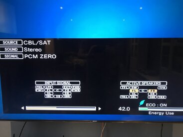

Hi Tony,
It may be a code 18 error but not entirely sure. I reran the manual setup and indicated I had not more than 9 speakers. Now, when it came to setup the ceiling speakers, the setup assistant gave me the choice of 2 or 4 speakers whereas yesterday it would only offer the 2-speakers option (strange). I was able to make all 9 speakers work in the end.
Also, I did not find the feature to check whether the outputs were on in the setup menu but I found the following (attached) when pressing the info button.Please let me know where to find it since it would be very handy.
Thanks again and have a great day!
