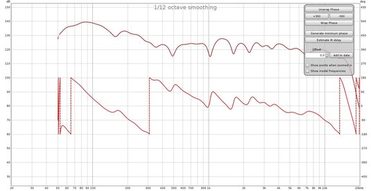

Hello, John. Please, can you add a delay on loopback input? It's very useful for time alignment between loudspeakers range. For example:
1) I'm starting measurements from HIGH band of my loudspeakers system, and seen phase response something like first picture, because I actually have delay between loopback and mic, depending on distance from loudspeaker to mic.

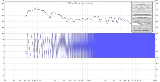

2) Then I click "Estimate IR delay", and seen picture 2. Ok. Excellent. I'm seeing my phase response without loudspeaker->mic delay.
3) If I will have function "insert same delay to loopback for next measures", I will see the clear phase response without air distance delay for all my next measures, and I will not need to manually insert this delay value after make measures my other loudspeakers and bands for time align components of my system.
Thank You!
