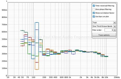

It seems you have a highly position dependent resonance mode there. Is it possible that your room is about 2.8m high and has one axis also around 2.6 to 3m? Above and below 120 Hz your reverberation time RT60 is fine.
Looking at the linearity, I would try to pull out 2-3 dB at 290 (could help with muddiness) and at 800 (could with nasalness of voices).
