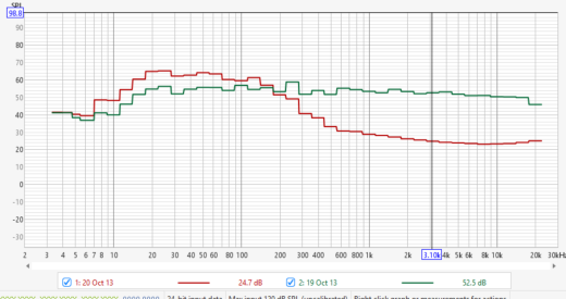

Please use -20dBFS wide band pink noise as signal and raise the center channel volume to 79~85dBC, then check the LFE increment is +10dB over center channel on 1/3 octave RTA datum.
It should something look like this:

Here's correction frequency response. looks like there is the 10 DB difference between offload and LFE as you mentioned

Well, REW is a bit of a struggle for me, but ultimately I think AL is looking correct. I'm not sure I understand why the other implementations seem to have the "bigger" bass with same target curve.

It looks like LFE +8dB (in average) on your 1/3 octave RTA...
I took that as "close enough" as this result could be due to user error since using REW is learning curve for me(but fun:)). For comparison, I was considering another set of measurements comparing the original results to the 10db correction as applied by the Anubis. Just haven't had the time to do so.
