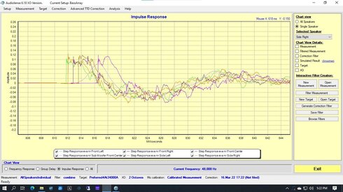

I measured each speaker individually by first taking allinone and then each speaker's measurements (in zip file).
The timings all seemed to move over to the individual measurement. Attached is the impulse response analysis for the measurement.
Should not this graph show the impulses all lined up or am I missing something here?

The impulses from the speaker by speaker measurement are not time adjusted, that happens late in the correction process. The correct timing from the allinone session is saved with the measurement and accounted for in the correction filters and the simulations.

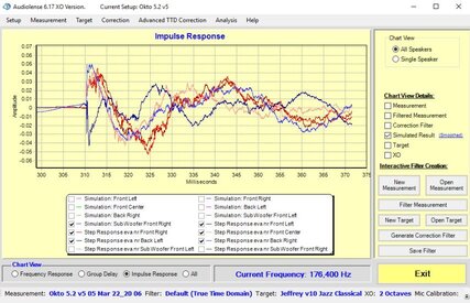

Bernt, here's my impulses after correction. Am I correct in interpreting this graph to mean that the back left surround is time aligned with the others, but out of phase? JCR

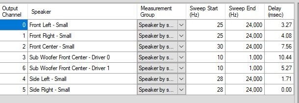

Hi Bernt,
I have to ask one more time about this -sorry:)
Something just seems wrong here.
Ok. I understand final processing does not occur until filter generation and the simulation presents as you explained in previous post.
But when viewing the IR measurements, shouldn't the measurement's timings reflect the corrected values from the allinone measurement? If that is the case, the graph for the IR measurements appears to display the incorrect delays i.e. the values you see after clicking the reset button and NOT the delays that were recorded by the Allinone measurement.
I suspect this is the case because when generating the filters everything audio seems to be "off", so I suspect the wrong delays are being used in the calculations. Is this possible?

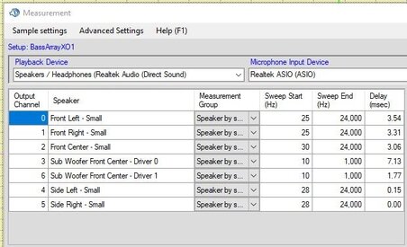

So what is the process here when using individual measurements. Is the idea to look at the IR graph for each speaker and adjust the correction on a speaker by speaker basis?
Regardless of that process, I've now taken a 2nd measurement and the result still seems to be off. Comparing the individual to allinone generated filters the allinone are vastly superior. It's easy to hear with vocals and instruments moved offcenter. In my case everything is usually pulled to the left side. Thanks.

You need to start with an allinone measurement to capture the real timing differences. If you reset or change the timing later all bets are off.
