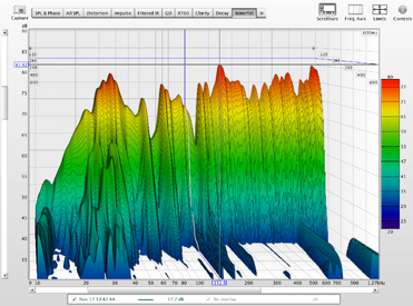

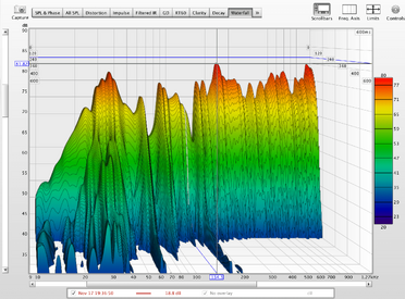

OK - sorry if I am making a fuss over low signal levels that are not really of consequence. I just want to make sure that I am viewing the scale of the waterfall plots correctly. I've attached a screenshot of the waterfall plots from the 2 measurements in the first file as meas_1.png and meas_2.png respectively. In both I have set the top of the visible y-axis to be at 90 dB and marked the highest point in the waterfall trace to be 81.82 dB. Then if you look ~40 dB down from that peak, I do see differences, e.g., in meas_2.png there are some trails for frequencies above 200 Hz that decay out to 600 msec on the time (z-axis) that do not show up in meas_1.png. And meas_1.png has a decaying component at about 65 Hz that does not show up in meas_2.png. I will check and re-adjust what you mentioned above and also measure and look at reducing the noise floor.

You may want to look at the rooms actual noise level. Those trails that you are attributing to ringing don’t look like ringing and are very low in level. They look like room noise.
Try measuring again after raising the volume level 3dB. If it’s ringing then the ridges will rise in level. If it’s just noise they would just show up randomly.

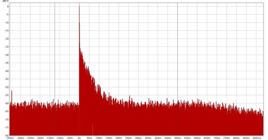

If you look at the impulse response plot in dB mode the level of the noise floor is pretty apparent, see below as an example.
