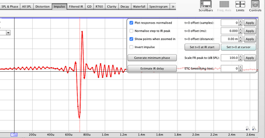

Hello,

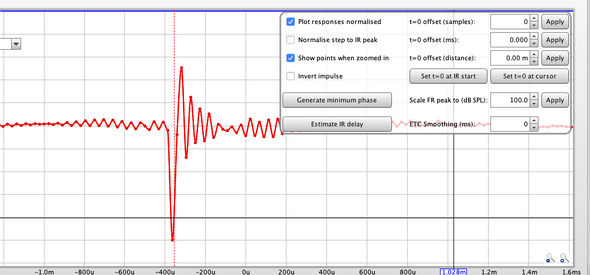

If i do impulse response offset it just shifts impulse without changing it. Phases changes as should be, but what causes impulse response waveform change if i do estimate time delay or set t=0 at cursor. What is the math behind this and why is that? What is happening here? REW version 5.20 beta 6
Thanks in advance,

attached the file and two screenshots before and after clicking "set t=0 at cursor
Screenshot 2019-03-14 at 23.00.50.png Screenshot 2019-03-14 at 22.52.04.png "

The problem is that most of your impulse response is missing, there is just a small portion from about -6 ms to 16 ms, then a discontinuity at each side. Fractional sample shifts are achieved using the timeshift property of the FFT, but the discontinuities in the response generate large oscillations at frequencies at and near Nyquist. It would be better to import a complete response and apply any windowing in REW.
