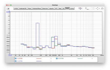

Hi all!
I just started experimenting with REW, using my UMIK-1 microphone, but I've noticed something that confuses me. If I do back to back measurements, with the same microphone position, speaker, volume, etc, I'm seeing very different impulse responses and decay times.
Why could this happen?
The frequency response seems to at least be the same:
Attached is 3 measurements back to back. Any ideas?

7,314
You are using a very long sweep, 1M. With a USB mic there will usually be a difference between the clock rate of the microphone (derived from the USB clock) and the clock rate of the output device. That clock rate difference will affect the impulse response shape, but not the magnitude response. It can be helped by using shorter sweeps (256k is plenty for acoustic measurements) and enabling the acoustic timing reference and the Analysis preference to Adjust clock with acoustic ref, which lets REW use the timing reference positions to correct the clock rate.
