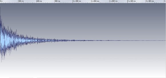

Actually the Peak is at 6ms in the file, if you load it in an editor you can see that. The question is why does REW place it in the middle? It seems to paste the second half of the file before the beginning...
Here is a screenshot of the file in Wavelab:
7,315
Ah, because of this, from the help: If the peak of the imported IR is within 1% of the beginning of the file REW assumes the IR is from a full FFT with the second half of the file containing samples at negative time, so the data is rotated to place the peak in the middle.

Aahhh thanks! It works now!
