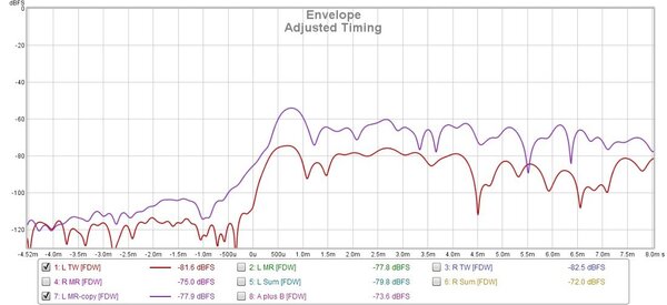

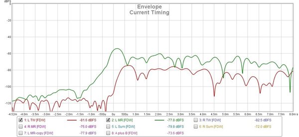

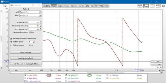

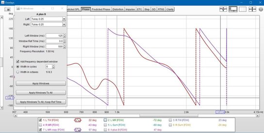

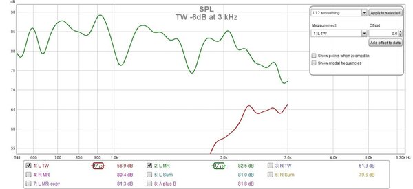

Your current timing seems reasonable just based on the locations of the IRs. They are not spread enough apart to suggest there is a clear error. It does hint that the TW is delayed an little more than ideal, but that cannot be confirm with this data.
The comments below are assuming the XO was engaged for the all measurements. This is a requirement for delay analysis.
Per the SPL chart t
he left TW is about 6 dB lower than the left MR. That indicates that
3 kHz is below the acoustic XO point. I would normally want to see a minimum of 2 octaves below and above the acoustic XO frequency for both drivers. If the acoustic XO is actually 3.4 kHz the minimum range needed would be 850-10.2k Hz. That would be enough to support my normal method of phase tracking analysis. As I indicated however that process doesn't work reliably in an automotive application anyway.
Given just this data I don't know of any reliable way to perform an analysis, but I tried to do that anyway. Below is a best guess based on
the left TW-MR XO
I looked at it 2 ways and they both seems to agree. Assuming the XO frequency is actually very close to the 3 kHz provided here we can:
  1. Look at the lower half of the XO for phase tracking and predict the upper half by based on experience.
  2. Align
    timing based on
    the ETC as the proximate center of the XO is the measurement cutoff. The initial energy peak is the highest frequency that is measured so that is 3kHz for both drivers. The initial peaks should thus be aligned. [Just my own expectation/understanding.]
The finding:
  • Reverse the polarity of the TW and reduce the TW delay by 0.6 ms.
I did not analyze the right channel in as much detail as the left, but it appears to benefit from the same change.
I suggest that your method is likely as good, or possibly more likely, to work well given your experience. I am not suggesting you should evaluate this change or that there is a high probably that it would be an improvement. It's likely that the SPL support and sound quality would not be significantly improved. It was more for my own interest to see if anything could be derived form this data.
Some charts:

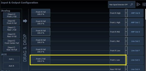

hi members,
Interesting thread to me here but I've tried it in my car but failed to do so. I wish any experienced members here could further guide me in this matter.
My vehicle is right hand drive. In my case, Left midbass (passenger door) is the furthest speaker so i choose that as timing reference output. I set the L channel in REW as timing ref output. Attached was my setting make to DSP IO for the process (i not sure if i am doing right).
"wait for timing reference" was check in measure pop up dialog box. I started with the right Mid Range so i muted all other driver in helix dsp except for the left mid bass and right mid range. i also set my start freq from 1000hz and end 1001hz.
my first problem is i didn't hear any reference timing sound come out from the reference channel before the sweep sound on right mid range.
second problem was at some point, it just stopped at around 19% and indicated ....waiting for timing reference.... (i have to cancel)
i not sure what was set wrong.
I am using UMIK-1 usb connection from laptop and laptop bluetooth to car player for the REW measure process.
