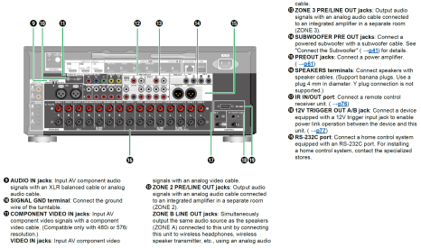

So I've now owned the VSA-LX805 (aka VSX-LX805) for nearly a year and I would like to connect an old Panasonic S-Video VHS tape player to my system to enable some old VHS tapes to be viewed.
I'm not exactly sure of the best way to do this and would appreciate some advice on which cable I should use.
On the back of the VHS player I see the following connections:
The manual for the VSA-LX805 amplifier shows the following:
When this VHS player was in use, around 20 years ago, I believe a SCART cable was used to connect it directly to the TV. Is there such a thing as a SCART to HDMI cable?
Would it be better to use the S-VIDEO + L/R Audio connections, but how would the other end of the cable look and what would it plug into on the amp?
Thanks in advance.

Hi @milleniumaire, there are SCART to HDMI cables although I have never used one... Google is your frenemy... Or use the S-Video out yellow is the video and white/red are stereo audio...
Number 9 on your above A/V amp is audio input and 11 looks like Video in... You will need 3 RCA male style cables or you may be able to find a single cable which bundles all 3 into a single AV cable, again RCA male on both ends... Again Google is your frenemy and Amazon usually has this kind of consumer AV gear and accessories... Good luck!!!

Thanks for the response.
I have done lots of Googling and examining of potential products, but nothing stands out as being a definite solution. The SCART to HDMI converters get mixed reviews with comments that the picture quality isn't great and that the products are of poor quality and so don't last long. They also seem to require power to drive the electronics.
I have seen some "s-video" cables, which don't use electronics, but it is difficult to determine if they definitely support s-video and I'm not sure what connections must be used on the amplifier end.
You yourself state I need "3 RCA male style cables". My understanding is this will not provide the better s-video quality.
On the "Super" VHS player, there is S-VIDEO, VIDEO, and Left and Right Audio connections. Yellow, white and red connectors will give Video and Audio but it will not provide the better S-Video signal, which I believe requires use of the 4 pin DIN connection or the SCART connection. If the 4 pin DIN connection is used for S-VIDEO, the white and red RCA connectors are also required for stereo sound. I assume the yellow video connector would not be needed when using the 4 pin DIN connector, but I'm not 100% sure about this.
So, assuming I'm able to get a cable with a 4 pin DIN connector and 2 RCA connectors for audio, what needs to be on the other end of that cable? The amp doesn't have a 4 pin DIN socket! I had assumed it would be the component video sockets (number 11) and I assume these would only carry video, so 2 white and red speaker connections would also be required, but I'm guessing. Unfortunately, the manual isn't very helpful.
Rather than having to use a poor quality powered SCART to HDMI converter, I'm swaying more to using the 4 pin DIN socket and RCA sockets, but don't know how these would connect to the amp!

Interesting problem... I dig the fact that you've got a high-quality VHS player and that you're looking to use it! Have you seen (or looked at) something like this? (link)
I've never used anything like it... but it has solid reviews. For only $20, I think it's worth a swing. At worst, be careful opening the package because you can always return it.
Thoughts?
Thanks Todd, that kit looks like it will do the job and isn't one that I have found during my Googling. Some of the reviewers talk about the aspect ratio not being handled correctly, so I need to check if I can set this to 4:3 on my TV. Thankfully, I see this and lots of very similar "copies" are available in the UK. Yesterday, I also came across a reasonably priced device that converts s-video to digital and stores it on a USB connected device. We probably have around 20 VHS tapes that would be useful to convert so I'm now considering this as an option, meaning I would then be able to get rid of our old VHS player as it would no longer serve a purpose.
