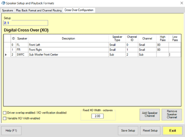

When i enter anything into the lowpass section for the sub it immediately gets erased. How do i add a lowpass to the sub?

You set the lfe low pass on the speaker tab:
53927
Also observe that FL and FR has different bass offloading frequencies. Those two plus the LFE cutoff means that the subwoofer has three different lowpass frequencies here. Sometimes the number can be higher.
The subwoofer will have one correction filter for LFE, another for integration with FL and a third for integration with FR. And since there is only one line for the subwoofer in the crossover tab, there isn't enough room for this info there. But for bass offloading it will always be the mirror image of the high pass frequencies entered: The same frequency and the same XO width as the high pass side.
