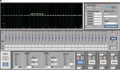

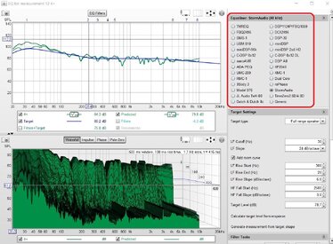

is it possible to use REW EQ window to make recommendations for 31 EQs?
