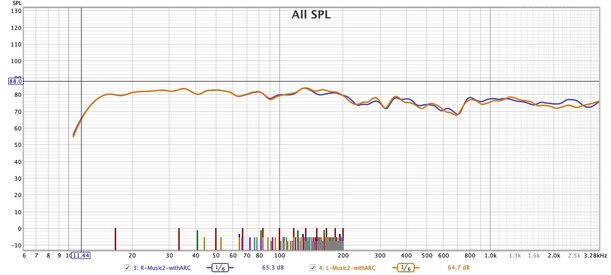

Got pretty good results with the two subs, MiniDSP and ARC. I setup minidsp to cut the high areas and boost a max of 2db.
I did bump up the sub a bit after I took this measurement. Sounds awesome!

Yeah... that would sound like no bass and a bit bright to me... but I do like my bass heavy.
