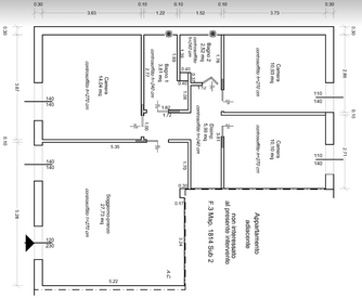

Below I'll show how the place currently look, and the construction changes introduced by my project:
current state of the place:
My project:
So as you can see, I've given the room a more rectangular shape, the sizes are (H,W,L) 2.7m x 2.86m x 4.75m - room ratio is approximately 1 : 1.06 : 1.76

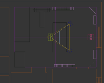

I've implemented your suggestion in the project, as the image below shows.
The blue box are my Kali lp6 v2, they follow the equilateral triangle placement rule and they are 87cm away from the front wall - and I've also moved forward the 16cm rockwool acoustic panels at the side of the desk to flank them, this change also removes the option of having an angular bass trap in one of the corner of the room, but then, would I even needed it if is only one?!
I'm still unclear on the window situation, if it would do more good or harm centering it with the room or not - by doing so I could potentially have angular bass traps on two corners, on the other hand, I've read a centered window is bad... can you guys confirm on that? ^_^'
Another thing to notice is the PC screen 60cm in front of me (the blue-ish rectangle on top of the desk), I've gave it the size of a 32' monitor (72cm wide) and I'm afraid it will block the direct sound a bit, is that a worry? What do you guys think?
I've came up with this "hypothesis" which is more of a wild guess: if I can see the tweeter from my listening position, then my ear can see it too so all is good.
So I should be seeing the tweeters still with this setup, what are you thoughts on that? Should I spread them more apart going outside of the equilateral triangle, or they are fine the way they are now?

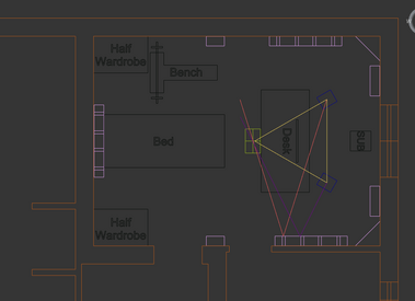

Many changes to the project followed so image below is the new planned "state of things" :)
The room got bigger, new measures are (H,W,L) 2,70m x 3,48m x 4,75m - which through amroc I can see puts me inside the Bolt-area, that should be good right? :S
The room is 44.63 m3 and the pink shows where I can afford to put acoustic treatment, that in the image shows three 120x120 panels, two 30x120, two 50x120 in the front wall and two 41cm angular bass traps.
Now for the questions:
1) As you can see I have two very tall half wardrobes in the back wall corners flanking my bed, this was done to keep symmetry, but I don't actually need two, I could live with only 1 and using the space of the other for a small desk/table.
That would introduce asymmetry though, how much of a bad/noticeable impact you think it would have compared to the current setup?
2) About those huge half wardrobes, they're so tall that... does this shape still count as a rectangle? Or is now an "odd shape"? Am I introducing more problems in the room?
3) Window - I've centered it in the room. Will this be cause for concern? I can have it off-center as well. There is any agreed upon objectively better placement for it?
4) Do I have planned enough treatment for a 44.63 m3 room such that I don't have echo/reverb and pretty much good sound with a little EQ tuning?
5) How important is the ceiling treatment for this room? Assuming one would treat it, where should they treat it exactly? I'll be honest with you, I'm afraid anything hanging in there would fall and smash my PC setup and head...
6) What types of panels I'm supposed to use where for a general good result? For now, all the panels in the image are16 cm thick what I think is called "porous absorbers"
I think this is enough questions for now :D
A couple of things to consider. I've never heard a triangular speaker setup that didn't sound better with the speakers farther apart (wider than the triangle). I'm not saying every speaker is the same, but I know I've listened to more than I can count. I would consider the Cardas recommendation for placement: https://www.cardas.com/system-setup ... then I would experiment with the listening position, moving forward in the triangle, and it should begin to sound more immersive with better imaging and a broader soundstage. This would likely resolve your monitor issue, and you could also move it back a little on the desk, if possible.
I don't think the window or any asymmetry will have that much of an impact, although I'm a bit OCD about symmetry myself. :whistling:
As for ceiling panels, the mirror point between you and the speakers is typical, but I don't know if it will make all that much difference. You could first try listening without acoustic treatment and see how it sounds. If it's too lively, you could add a few panels here and there to help with the acoustics. With your room as small as it is, my guess is you'd probably want to stick with 2-inch to 4-inch thick panels.

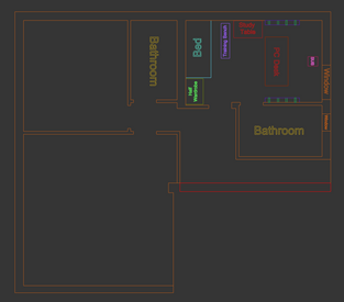

Meanwhile, I've finalized my project!
Apologize for the italian naming on things, anyway the conclusion I've reached was that I needed to take the bathroom door and the half wardrobe out of the room, so I've concocted this setup, with a small antechamber before my room.
The bathroom door needed to be gone because it might be taking away space for treatment, the half wardrobe needed to be gone because it would break symmetry and I have no idea how that big hollow space would interact with sounds, so I've brought both outside of the room.
Now I can place 60cm bass traps on the corners no problem, so if the need for them arise, I've set up myself for success :D
