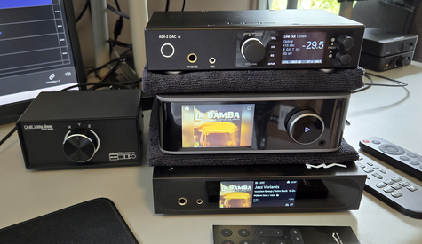

This test is relatively simple. I’ll use a couple of switchers, one 6.35mm and another 4-pin XLR, to switch between two or more amps while listening to specific clips of songs and some listening sessions with my playlist. I have an optical splitter, so I can use one of a couple of streamers I have on hand to feed multiple amps simultaneously. I can also group Roon Ready streamers to play simultaneously if needed. I will level-match the volume of each amp using my EARS headphone rig by playing a 1kHz sinewave via Room EQ Wizards generator and then level-match with the REW SPL meter. I can also run sweeps of each amp and see if there are any level differences at other frequencies. Some will suggest the EARS system is inadequate because it does not align with the more expensive systems such as GRAS. However, it is sufficient for measuring levels and differences as long as the headphones are not disturbed between the measurements. The headphones used will be the HIFIMAN HE1000se. They have several hundred hours on them and are the best headphones I’ve ever heard, although I keep searching for better. No… I don’t believe all headphones sound the same, but some sound similar to my ears in my evaluations. I’ll listen to various tracks I am familiar with via Roon from Tidal, Qobuz, and our library of CDs transferred to our NAS server. These are all WAVE or FLAC files. The good thing about this test is it doesn’t have to be blind because I have no reason not to be brutally honest with myself. If there is a notable difference, I hope to measure it or conduct blind testing for a self-check. These comparisons will not be completed in one day. It will be a few minutes one day, a few hours the next, and a day or two skipped between listening sessions, coming back to the same round of amps to confirm over and over what I am hearing.

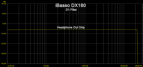

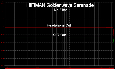

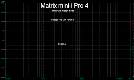

The Frequency Response is flat for both units—line out and headphone out—within the audible frequency range (20Hz to 20kHz). I have compared the filters on several of these amps and cannot hear any differences. Perhaps because the filters only affect the frequency beyond what we can hear. We can also see that the filters do not affect the lower frequencies in any response graphs. Remember, you can click on the graphs to enlarge them.

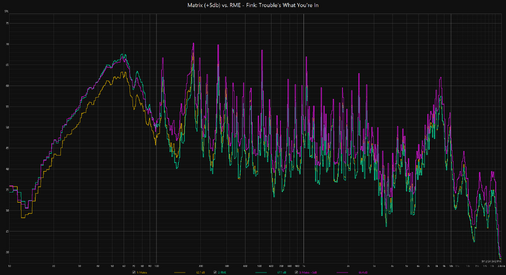

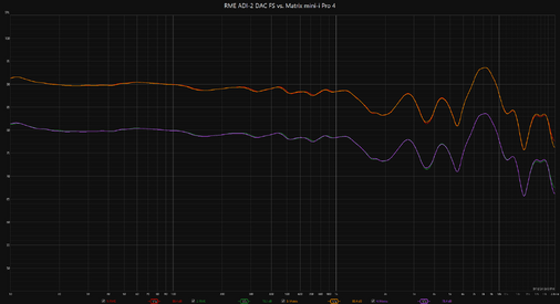

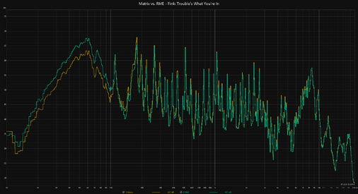

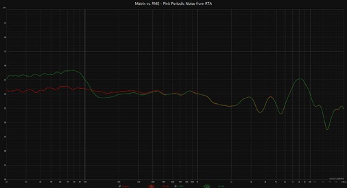

Hmmm… I immediately hear a difference in the first song when comparing the first two amps. Wow! This is a first. At the beginning of Fink’s Trouble’s What You’re In (from the live version 2012 – Wheels Turn Beneath My Feet – FLAC 44.1kHz 16bit), he slaps his guitar to create a kick drum simulation centered around 60Hz (known after measuring). The slap on the RME is more pronounced and has more resonance. Flipping back and forth, it is easily noticeable. How could this not have shown up in the FR measurements? Those measurements were with the sweeps generated from REW and sent through the USB cable. We are streaming via Ethernet but still using the same headphone outputs. I’m scratching my head. Surely, this would be measurable.
I measured the frequency using the song and REW’s RTA (30 averages). I notice that 60Hz is higher on the RME, but they are very close as we move up in frequencies above 100Hz and through the midrange. This is why the bass seems heavier on the RME, but the vocals are almost identical.
If I increase the Matrix volume level by 5 dB and remeasure both, the bass is almost level-matched. However, the midrange and vocals are louder on the Matrix, which makes the song sound louder when switching back and forth. You can easily see this in the RTA graph showing the 5 dB level increase in the Matrix measurement.
Let’s play full-range pink periodic noise recorded to a wave file in Roon.
The RME boosts the low-end 5 dB as if there is a low-shelf filter at 100Hz. This is where the issue lies. All the settings in the RME are the same for optical input and USB, so the difference doesn’t make sense. EQ is OFF everywhere in the RME, and the loudness setting is OFF.
What about the settings on the WiiM Ultra feeding the RME? I'm looking at the app on my phone for the first time. The EQ on the Ethernet input source is set to ON, with a 100Hz low-shelf filter. This is why we did not see it on the USB input, as the EQ was set to OFF for USB… and only set to ON for Ethernet. So, any streaming was getting a low-shelf boost. Now, the difference makes sense. Lo and behold, how can that be if this is a new unit? Surely, this is not WiiM’s default setting. I have not touched any of the settings on the WiiM Ultra, so I wonder if I may have received a returned unit from Amazon.
In one sense, you could say I proved I can tell a difference in amps. However, a filter helped me a bit.

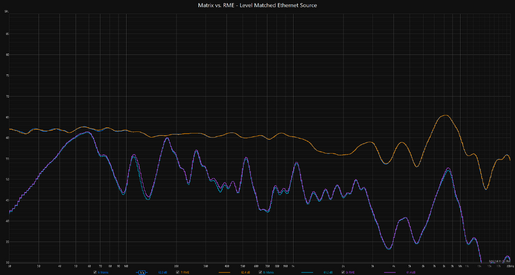

Okay, so let’s measure the song and the pink noise file again.
It's very close… within 0.2 dB. Let’s listen to Fink and see if trouble’s still what we're in here.
Switching back and forth, there is zero difference. The 60Hz guitar slap sounds the same on both amps. Vocals are identical, and string plucks are perfectly matched. Switching back and forth through several other song segments and full songs, I cannot identify any difference between these amps. They both sound excellent with the HEKse headphones. As a side note, these amps featured the ESS ES9028Q2M DAC vs. the ESS ES9039Q2M DAC. There are no differences between the DACs. Thus, implementations of their respective DACs appear to be well done.
I thought it was reasonable to include the initial issue I experienced with the WiiM EQ being on. I could have easily skipped over this and started with a clean slate, but it serves as an example of how some comparisons may be different, and unless measured, we may never know exactly what was causing it.

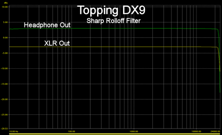

The frequency response is relatively flat on all three units in the audible range. The Serenade deviated at the extremes by 0.2 dB SPL.
All three levels matched to within 0.3 dB. The slight variation below 10Hz for the 78 dB level should not matter, as I do not notice any sub-bass at that level. The 88 dB level is where I begin to notice sub-bass rumble, and there is hardly any deviation in those measurements. I would expect to see some variations from round to round due to the slightly different placement of the headphones on the EARS rig. The Serenade will be aggravating to level match because it has no volume level indicator. Each time I change the volume level, it must be releveled. I appreciate a digital volume-level read-out because it gives me a reference.

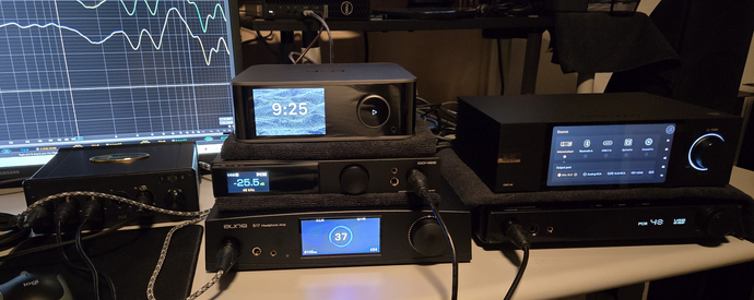

Eversolo DMP-A6
– FR - 20Hz~20KHz(±0. 15dB) / SNR: >128dB / THD+N: <0.00009%(-120 dB) @A-wt ES9038Q2M*2 DACs
Fixed full volume via XLR to the Aune S17 Pro amp.

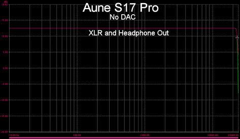

Aune S17 Pro – Amp Only
  • 6.35MM JACK HEADPHONE OUTPUT
  • Freq Response: 20Hz - 80kHz (+/- 5dB)
  • THD+N: < 0.00038% @1kHz
  • SNR: > 115dB @600Ω
  • Crosstalk: < -105dB @1kHz 600Ω
  • BALANCED XLR HEADPHONE OUTPUT
  • THD+N: < 0.00016% @1kHz
  • SNR: > 116dB @600Ω
  • Crosstalk: < -110dB @1kHz 600Ω
  • G-L 6.35mm jack headphone output (Low Gain)
    • 738mW @ 32Ω
    • 250mW @ 100Ω
    • 166mW @ 150Ω
    • 100mW @ 250Ω
    • 83mW @ 300Ω
    • 53mW @ 470Ω
    • 41mW @ 600Ω
  • G-L Balanced headphone output (Low Gain)
    • 2773mW @ 32Ω
    • 968mW @ 100Ω
    • 645mW @ 150Ω
    • 388mW @ 250Ω
    • 333mW @ 300Ω
    • 212mW @ 470Ω
    • 116mW @ 600Ω
  • G-H 6.35mm jack headphone output (High Gain)
    • 2020mW @ 32Ω
    • 675mW @ 100Ω
    • 453mW @ 150Ω
    • 273mW @ 250Ω
    • 228mW @ 300Ω
    • 145mW @ 470Ω
    • 114mW @ 600Ω
  • G-H Balanced headphone output (High Gain)
    • 7507mW @ 32Ω
    • 2643mW @ 100Ω
    • 1793mW @ 150Ω
    • 1089mW @ 250Ω
    • 908mW @ 300Ω
    • 580mW @ 470Ω
    • 453mW @ 600Ω

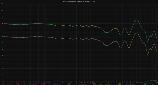

Frequency responses are flat on all amps within the audible range.
Levels matched to within 0.2 dB for low-level listening and within 0.1 dB for higher-level listening.
Please see the details in Round One of what I am listening for. Unfortunately, there is still not much to discuss here, as I hear no differences in these three amps. I thought I heard something different on a couple of song segments, but after attempting to replicate it, I could not. These amps have stunning sound qualities when connected to my HEKse headphones. One note about the Aune S17 is I could fry an egg on top of it… it was HOT! There are no evident sound quality differences between the WiiM Ultra and Eversolo DMP-A6. I prefer the Eversolo over the WiiM Ultra due to the larger screen. There would be no way to choose between the products I’ve compared thus far based on how they sound, as they all are excellent.

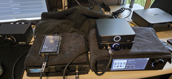

Listening Comparisons: Round Four (Final)
For this round, we’ll keep the S.M.S.L with its ES9039MSPRO DAC in the mix for our reference and add the iBasso DX180 DAP with its Quad (x4) Cirrus Logic CS43131 DACs along with the JDS Labs Atom DAC 2 + Atom Amp 2 bundle using the older ESS 9018K2M DAC. We’ll use the ONE Little Bear TRS switcher for these three. The Eversolo DMP-A6 will be the preamp for the S.M.S.L and JDS Labs amps. The iBasso DX180 will be via the PC USB port. The DMP-A6 and DX180 will be grouped on Roon to play simultaneously.
Eversolo DMP-A6 – FR - 20Hz~20KHz(±0. 15dB) / SNR: >128dB / THD+N: <0.00009%(-120 dB) @A-wt ES9038Q2M*2 DACs
Fixed full volume via digital optical to the S.M.S.L DO400 and the JDS Labs Atom DAC 2 / Atom AMP 2 combo.

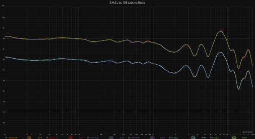

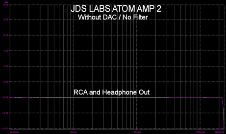

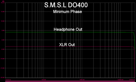

As expected, the frequency response of all three amps is flat in the audible range.
Levels matched to within 0.2 dB for both listening levels. The JDS Labs unit is like the Serenade in that neither has a volume display, thus requiring relevel matching when changing the volume.
Amazingly, the iBasso DX180 sounds as good as these other amps. The JDS Labs Atom 2 combo is a little over half the cost of the DX180 and the least expensive of all the amps tested, yet equally as good as the most expensive amp. The DX180 also contains our entire CD music library on its SD card and has Roon. The portability makes it an excellent option for around the house and on the road. The 4.4mm balanced headphone output provides ample power and sufficient headroom while listening to my HFM HEKse headphones or UM Mest MKII IEMs. Its portability could eliminate the need for an extra amp, but what fun would that be? An avid enthusiast like me needs multiple amps, even if there is not much of a justifiable reason short of want.
Conclusion
Ultimately, I cannot identify any differences in these amps, but that does not mean anyone won’t be able to, and perhaps some may hear something in one that they prefer over the other. Your pocketbook and your ears will help you decide. My only recommendation is to be honest about what you hear and do your best to use a controlled testing environment if possible. As for me… I enjoy comparing speakers and headphones more often, for which I know I can hear differences. Yet, this was still a fun comparison to ensure I was not missing out on anything, and I am confident I am not. I’ll keep the S.M.S.L as I like some of its Sound Color options for fun. I’ll keep the RME ADI-2 DAC FS mainly because I like its loudness feature for listening at lower volumes. The DX180 was already a house resident and will continue as a convenient portable DAP. I’m not crazy about the Serenade or the JDS Labs due to their lack of a digital volume display (picky – I know). The Topping has too much bling with the clear top, and it gets a little warm but not nearly as bad as the Aune S17 Pro, which is too hot to touch at times. In the end, it was the features that helped me choose the amps I wanted, not the sound. The End!
