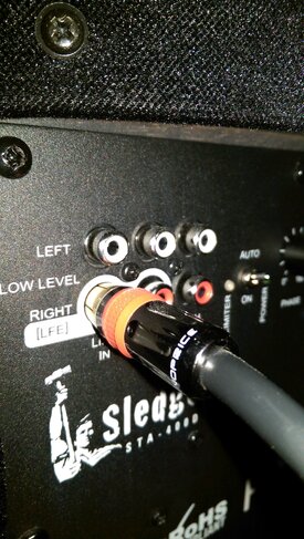

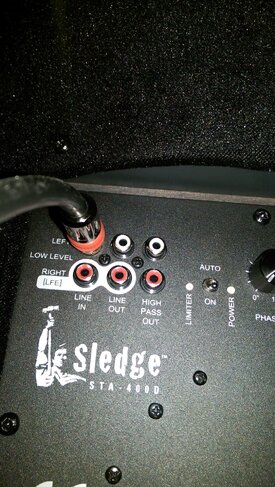

The first photo is how I have had it connected. Now none of the top three white inputs work. In order to get any sound I have to use the red LFE line in input, second photo.
Is this ok to do? I feel like the bass is too aggressive as compared to the other sub on the same line when I just tried this...don't want to damage the woofer. My bass test is scene 33 of Brave, the bear fight.

The second one, how you have it connected now, is how you should have both connected. LFE is the correct input. Plug both into the LFE inputs and then rerun Audyssey.
FYI... the top three white connections are NOT all inputs. ONLY the far left. Read the labeling. The white is LEFT and the red is RIGHT. The first set of red and white vertical RCA's are the inputs. The second set (middle) red and white RCA connections are for full range outputs to another sub or another amp if you were using a different type of setup. The third set (far right) red and white RCA connections will only OUTPUT a high pass signal if you were using the built-in crossover on the amp, which you are not using... you are using the crossover in your Denon. So the second and third column are OUTPUTS ... NOT inputs... you won't ever get your sub to work plugging into to those from your Denon.

It's probably a loose connection on the inside of the sub. If one is working, I wouldn't sweat it...
I have this image of you towering over me stating the above and scowling..
lol... no "scowling" ... just making sure I was very clear in my wording so as not to get confusing.
As Todd stated, I wouldn't sweat it... you are now using the correct inputs and all is good.

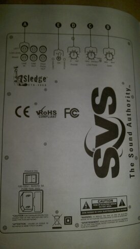

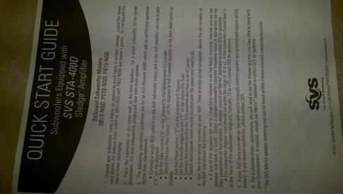

First photo is svs install instructions which is how everything was set up and working until recent.
Second photo is svs photo of back of sub.

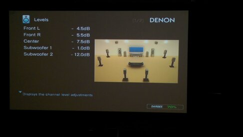

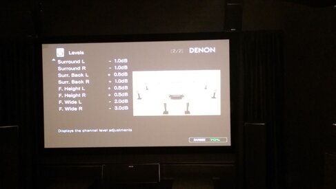

After EQ this is the levels things are set at...photo 3 & 4. Things dont look right for the subs. Sub 1 is front subs, Sub 2 is back subs.

Do you have an spl meter?
Perhaps you accidentally bumped the gain up on one of the rear subs and the AVR is just compensating for it?
what's the range I should be getting on the meter, I don't recall? Also should I be using the white noise function to measure? And is that a function on the avr or on a setup disc? I forget. Dont do this a lot, last time was like 4 yrs ago. I mean when you get it right no reason to mess with it, ehh
