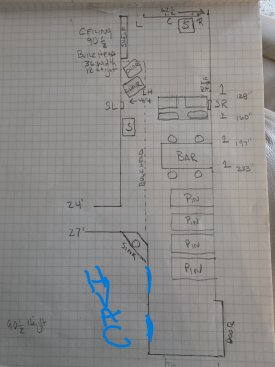

A diagram would really help, showing stairs, doors, and other features including location of your mechanical room.
Isolation is a different (and usually much bigger) problem than controlling reflections using acoustic panels. The panels can help with higher-frequency sounds, but even then as mentioned above sound can easily sneak around the panels, and low bass travels through walls and ceilings despite the panels (which help somewhat but not so much for low bass). There is also transmission through HVAC ducts. Isolation usually requires heavy hanging walls and ceiling (plus floor if not at ground level) and duct mitigation (either baffle or remove and use an independent air system -- I used a minisplit for the media room so no ducts to the rest of the house). I attached a file showing what I did when they built our media room; not sure what or how much you want to do now. If you could wall off the area, or at least install a heavy (exterior with weather seals) door to the upstairs, that might help.

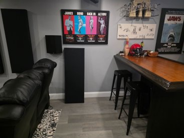

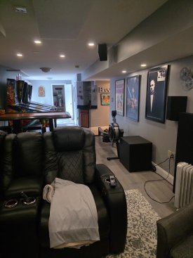

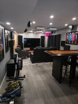

@DonH57 Wasn't going to ask folks to review that level of detail, but since you asked....😁, see attached drawing (1 block = 1 ft) and photos. Note, things have shifted just a bit since I made this drawing. I got rid of 1 chair, added 1 pinball machine, and put up 2 more height channels which shifted the placement of the 2 in the drawing as a result. The photos are current.
ALL: I probably just need to clarify my objective a bit. I'm aware that I'm working with a non-ideal space (won't be knocking down walls to change the broader layout that includes other rooms) and am realistic that even with a solid wall & door, sound will still travel through the floor, vents, etc. My goal is not to stop all the sound between upstairs / downstairs or between the theater and the HVAC. I just want to "knock the edge" off the casual sound that comes from people speaking upstairs and to not hear the hvac fan cycling on and off as much. I do have moving blankets covering the inside of the louvered doors marked in blue (don't worry, there's plenty of airflow to there via other means). Even just that is a bit helpful. I have also thought about putting a permanent door down the hallway where the "Brew" light is in the photo. That hallway leads eventually to the stairs where sound goes up and down between the floors. That would help a lot I'm sure, but won't address the white noise from the HVAC fan or the general openess of the sound from the large space behind you when watching a movie. Thanks!
