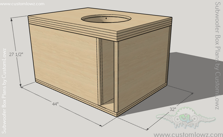

So I have two subs currently. Right now they are both placed in the center of the front and back wall. I don’t know if I’ll be able to go in the corner because it’s going push my main really far in just because of the enclosure size. Here’s my enclosure for my subs. Two of the same. I have it rear port and downward firing a few inches off the ground

Are the drivers firing up? I would try to fire one of them into the corner.
You can also try changing the distance on just one of the subs... make it 5ft (or 5ms) farther away.
I know that might sound a little wonky, but it can work and you'll never notice that small of a timing difference.
