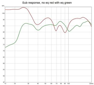

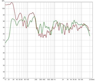

Hi everyone, I'm trying to learn how to properly take measurements and then apply the proper room treatments to my theater. I have read through several posts in the REW threads, it's a bit overwelming really. Can anyone tell me if these look like I'm on the right track. I did a full range, from the main listening position, red is with Audessy off and green with audessy on. 1/6 smoothing. My theater room 14.5 x 20 x8 The front wall is treated with 1 in lincoustic, the room is carpeted and has a droped ceiling with 1in rigid fiberglass tiles(look like rigid lincostic ). There is no treatment behind the screen 110in. Main speakers are Martin Logan 40 towers, there is 2 -15 in ported Rythmic subs, positioned along the front wall, 1/4 in from side walls.
