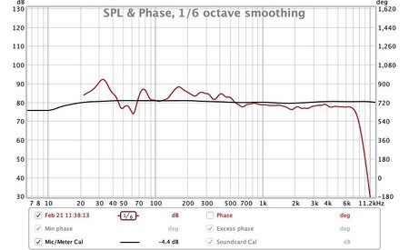

Here is my best attempt at being an artist!! I moved the speakers a bit and managed to get better measurements. Don't understand why the roll off at the high frequencies except that I was running the test generator via airplay to a Bluesound node2I.
Room is 22 feet long. The drawing appears to show 27 but is 22' long.
