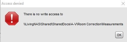

I have similar or same issue writing to share. I've checked security in both windows and on NAS. As a workaround I was saving to desktop and moving them to NAS with explorer.

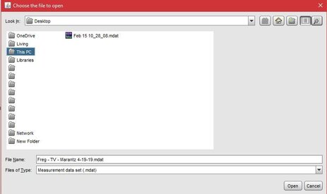

Additionally I was having issue getting to the share from open menu, but I am able to get to them from the "My PC" path now. At present there share is mounted using NAS username, that username owns all the files, share is connected with drive letter. If I go to home icon in it shows unnamed folders some of which eventually open as disk and a couple are not expandable. Attached pic of that as well.

When I tried running as administrator earlier I could see the share. Tried again after posting above. I get the same write access failure when REW is run as administrator.
7,212
Seems Java's isWritable() has some issues with network shares, I'll change the way access is checked for the next beta.
7,212
Since beta 42 REW hasn't relied on the Java runtime to say whether a location is accessible, it tries to create and then delete a file in the requested location and if it can't do that it shows an Access Denied error.

The behavior is similar (think is the same) as earlier issue (the Java related issue). I use the 64bit version. When I attempt to open a measurement file on NAS share, unable to see NAS in network folder. I can workaround by opening file in explorer. When I make a new measurement (different computer WLAN laptop), I can't save file to NAS for same reason (doesn't see NAS). Workaround save desktop and move file with Explorer. Was working in rev 47!
I do mount the NAS share as drive S: using credentials specific to NAS. In NAS all NTFS ACL. NAS is QNAP.
Is there anything I can provide to help diagnose? Never actually an error because unable to see device and folder.
I tried on the read computer with "run as administrator". Same result.
FWIW, the opening dialog box never provides drive letter, it just shows folder icon and you have to open to find folders on those drives.

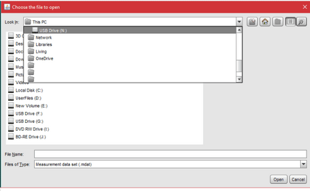

FWIW, I do not see the network shares mounted with a drive letter in my look in list. Nor if I go to This PC. If I go to desktop (house icon) I don't see any drives, but do see 8 folder icons w/o names.
In attached snip of using look-in it last shows N: and then below One-Drive similar un-named folders as see on desktop. The net shares are mounted as S: & X:. I have 11 devices with drive letters (USB multi-format reader uses letter for each format).
In REW on the Network folder I don't see NAS. I also don't see it as a network location in Windows Explorer. That may be the issue. Pretty sure used see it.
