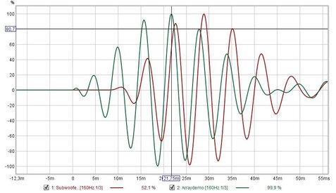

When I was examining my room I've used the 1/3 octave filters extensively to learn more about my room behaviour. As a byproduct I figured this kind of
filtering might actually be of use during crossover experiments.
I have tested that quite a while ago and shown that theory a couple of times to people that had difficulty in getting their crossovers to sum.

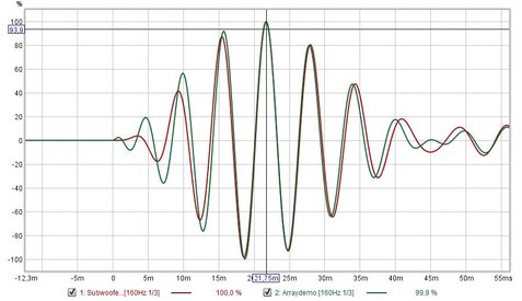

Basically I suggested to look at a 1/3 filter at the frequency where you want to cross with timed measurements of the two drivers, and use the overlay
window to see what the timing difference is between the two drivers.
Let's see a quick view of what that would look like:
Looking at an overlay window to determine acoustic offset between 2 measurements made with timing reference
Overlay view after setting the right timing offset by delaying one driver, making the crossover sum perfectly

If REW would have a user defined frequency where we could look at a 1/3 octave filtered IR it would make this method even more useful for crossover work.
Say I'd want to look at making a crossover at 1750 Hz, being able to look at the Filtered IR from both drivers involved, filtered with a 1/3 octave filter right there
at 1750 HZ would give the user a visual tool to see what's happening at the exact crossover point. As long as the measurements were made with a timing reference.
I don't know if it is even possible or easy to implement for you. If it isn't too hard to do, I bet this would be of use to many people.
One could use it on all kinds of crossovers that way, as long as they require an acoustic sum at a certain frequency.
I'm kind of hoping this isn't too hard to implement, so we get to see this option added in a future release. What do you say John?
