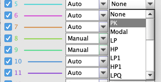

Hello!
First time I use EQ filters on REW. I have a very simple question.
Here is my room's response (right channel). Not bad but could be better. I'm only interesting on flattening bass frequencies.
I "calculate target level from response)" (55.5dB) :
Then I "generate measurement from target shape" and "match response to target" :
nice, my bass is smooth...but compared to my response above 300hz, too low, see the whole spectrum here :
I'd like simply to add an offset to the target and bring my bass (below 300hz) at the same level (60dB).
OR should I lower the frequencies above 300hz?
Which method is the right one?
How to?
Or did I miss anything?
Many thanks!!!
Michel.
