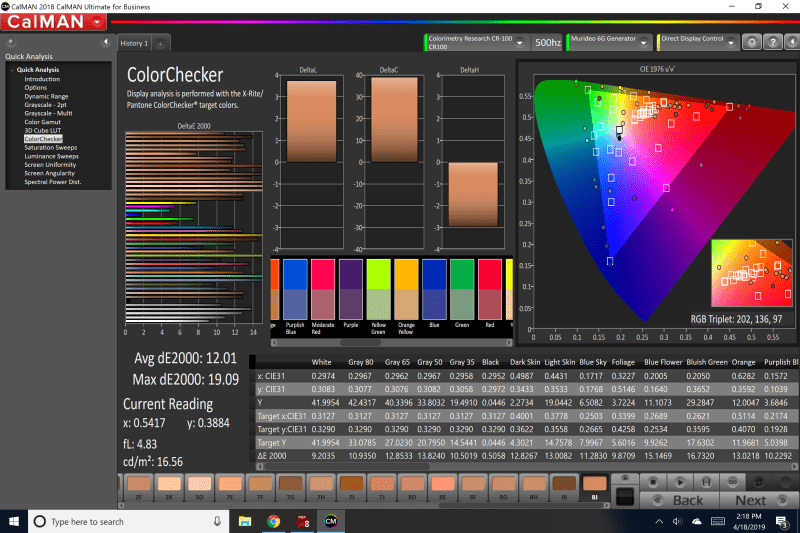

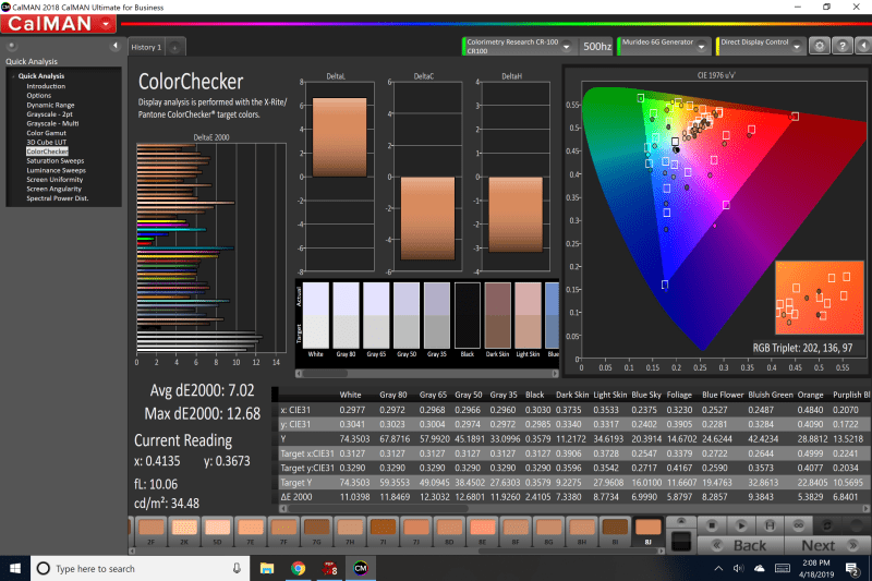

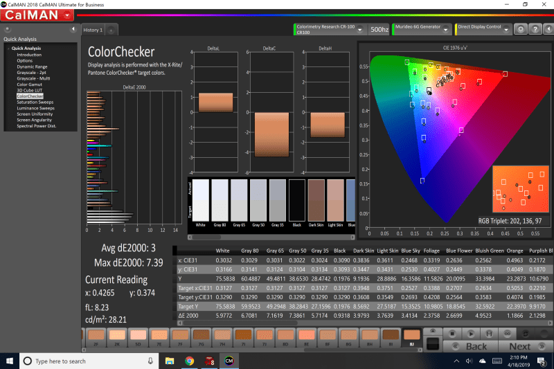

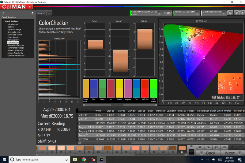

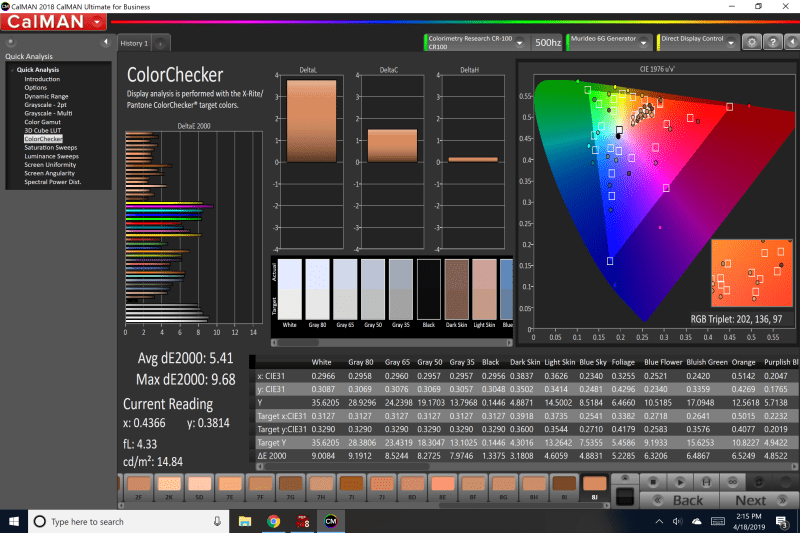

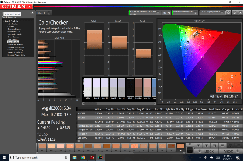

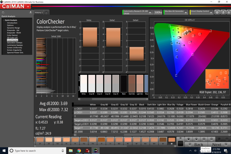

Epson has finally released it's replacement for the much celebrated 5040ub/ube line of projectors. I took that opportunity to update my 5040ube to a 5050ub and I'll post my calibration narrative here. All of these readings below are using SDR mode to measure except for Digital Cinema. Digital Cinema and Cinema are the two modes which engage the color filter to get expanded gamut coverage. The other modes do not engage that filter. In hindsight, I probably should have gotten some HDR readings from Cinema mode but from my experience with the 5040ube I've found that Digital Cinema is generally the much better mode for HDR.
Pre-Calibration
Dynamic
Average DeltaE of 6.4
Bright Cinema
Average DeltaE of 7.02
Natural
Average DeltaE of 3
Cinema
Average DeltaE of 6.04
BW Cinema
Average DeltaE of 3.69
Digital Cinema
SDR
Average DeltaE of 5.41
HDR
Average DeltaE of 12.01
Looking at the numbers, Natural mode looks outstanding out of the box for SDR with a DeltaE of 3. The rest of the modes look to fall within the realm of what you would see with similar displays out of the box.

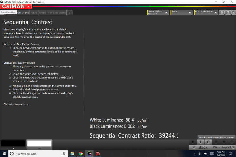

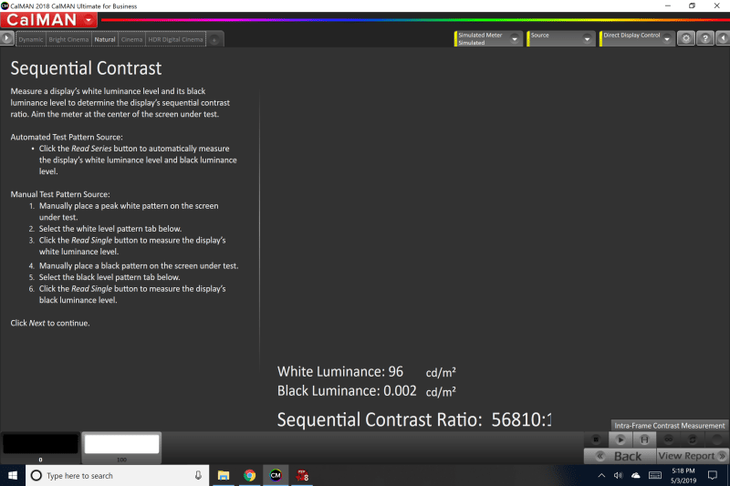

Contrast Ratio
Dynamic
Bright Cinema
Natural
Cinema
HDR Digital Cinema
These are out of the box values - non-calibrated. I'll wait until the 5050ub has around 200+ hours on it before I even think about calibrating it.

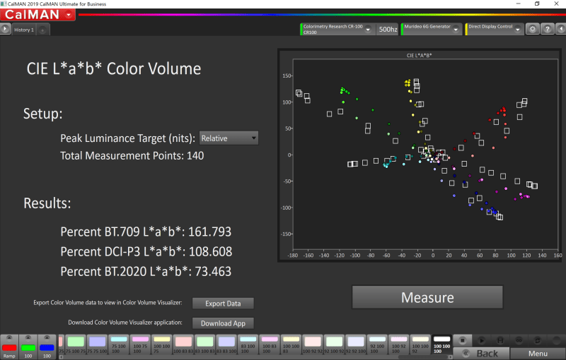

Installed CalMAN 2019 the other day and I figured I'd better get a Color Volume check on this new pj.

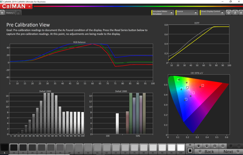

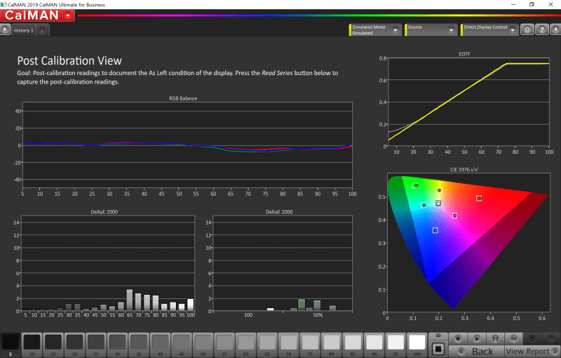

Projector has 97 hours on it and I spent a 2-3 hours calibrating HDR10. I've found that the best results calibration-wise and film content are to have the HDR slider at 10. When I watch hockey however, as I am now, that's too dark and I slide it up to 7. Here are the calibration charts from CalMAN - Digital Cinema mode:
Pre-Calibration
Post-Calibration

Looking at post #5, the HDR post cal grayscale readings are seriously off. Either it took SDR readings or something is terribly amiss. The line should look more like the pre-cal readings but with the red, green and blue lines being much tighter. :ponder:
Don't know why I never saw that originally but I should have caught that. Either later today or tomorrow I intend to calibrate the 5050ub. I'll put it all here.
