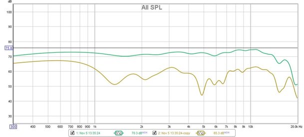

Attached find an in situ measurement I took. Not clean to very low frequencies but still shows a bit of what is going on.
PS. Kal I very much love your writing for stereophile. You, Fremer, and Atkinson are why I still subscribe to stereophile.
Here is a 5" fiberglass panel with a decent airgap and a 40 degree angle of incidence. 50F679D7-3A4B-424E-B8CD-D920FA35AB93.jpeg

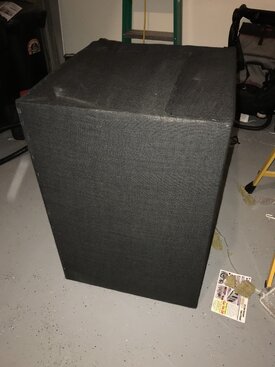

Sorry Tonto. Please don't be discouraged. We can help you get the results you want with nearly any reasonable budget. It just won't be so easy.
I built this giant 24"x24"X36" bass trap for under $50. In fact I want to say that I spent maybe $150 on materials and built two 5" thick 24"x48" panels, a 24"x24"X36" bass trap, and have enough insulation to make a few more panels.
Excuse the mess!
