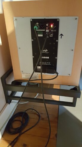

I'm running two B&W ASW 750 subs but I've changed the amplifier in one of them recently for a Hypex FA 501 to replace the faulty ASW800.
20191118_152708.jpgSounds as good as ever!
