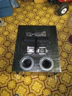

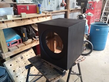

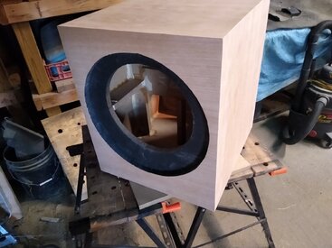

I am looking to upgrade my diy sub to a 15 incher from a 12. The cabinet was designed for a 15 but I used a 12 because it is what I had and did not have the cash to get a 15. I have seen that the Dayton Ultimax 18 is recommended on this forum. I am hoping the 15 is just a smaller version of the 18. My other concern is that the 12, I was using was a Dayton RSS315-HF and I do not like it at all. I swapped that out for an old Infinity reference car subwoofer that I wasn't using. (much better) I would like any suggestions in this basic price point $400.00 max. I am using the Dayton SPA500 amp.
Will this be for home theater or music? What are the cabinet dimensions?
There are a lot of car audio subs you can use. Comes down to budget space and ears.:) $400 is fine for most standard 15's. Some of the better HT 15's can be more.
You also need to simulate what your subwoofer will do in your box you have. Then possibly add some EQ or DSP of some kind. You dont have a large amp so you will need a driver that can work in your box. Ultimax might need more power to utilise its excursions. BUT it depends on box dimensions.
The box is 3.1 cubic feet. Dual 2 inch precision ports tuned to 35 hz. I can plug the ports if necessary or just to play and see the difference with REW. Mostly movies. 80/20. Thank you for the quick response. I will gladly take any suggestions. I do have access to a treo 15. Not sure what model it is. I also don't want to spend 400 for a 15 year old woofer.
I still have a pair of 18's that I'm no longer using. Great speakers, but I'm a bit more critical on my music listening so I have SB16-Ultras now. These 18's could take anything I threw at them... powered with about 2,000 watts each and pounded. My guess is the 15's are very capable as well.
I am probably going to put the 18's back in the room to use for movies.
I wish I had designed the box for an 18. If these are even in the same category as the SVS I am sure I will be happy. Sounds like they must be good for movie sound effects, and not as great for music. This is the first box I designed to look good and have the wife be ok with it. It costs as much to make them look good as it does to build the cabinet. Also takes twice the time. It was a fun project.
I built a couple of subs using the Dayton RSS390-HO 15s. Not the same sub but I would think very similar in results. They've worked very well in a single sub sealed enclosure powered by crown amps. But the best configuration was a sealed dual opposed box with the Daytons. That gets pretty large though.
But I purchased a servo controlled sub from Rythmik Audio and will never go back to non-servo. The G25HP Rythmik I puchased is also a dual opposed sub and works well in both HT and Music applications. Rythmik also sells components so you can DIY a sealed servo sub if you want to build your own cabinets. But, the dayton subs in a correctly constructed enclosure will be more than adequate! Just thought you would like to do a bit of research on another bit of technology.
It’s not what you asked, but you are likely to have a far greater audible improvement if you add a second sub. You didn’t mention how big your room is, but nulls and resonances are more likely the source of your dissatisfaction. A second sub will also reduce the power and output requirement for your first sub, likely dramatically lowering distortion. So, worth considering before a big project that might not improve anything.

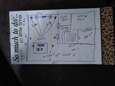

This is my second sub. My first one is a Cerwin Vega LW15. This is a 7.2.4 system. I am trying to build something that likely is not possible. I have a very limited budget and am wanting to build something similar to the SVS ultra 16. I have had to do this in stages due to the budget, plus I like building things. My room is difficult to explain. It is L shaped with full low pile rubber backed carpet that goes up the wall behind the front stage. Wood paneling with syrofoam insulation on the rest of the walls. This is a cinder block wall basement. There is a stairwell that is also carpeted. I did not include this in the measurement as I didn't really know how. My space is where the wife puts all of the things she wants to do later and also has my 6 year old's toys and a train table (pool table). So the clutter changes hourly. The main L shape is 5550 cubic feet.

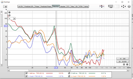

I did a lot of measurements with REW yesterday on the 2 subs. I am very new to this and likely was not doing things correctly. With near field measurements I was happy to se my DIY sub with the 12 outperforms my Cerwin Vega 15. at least with spl and the the smoothness of the graph. I haven't figured out how to interpret the distortion and other graphs yet. I also did some measurements from the seating position and the DIY outperforms there as well. I am surprised at how much the near field to seating position measurements are different. I have a couple of holes to fill and a peak to chop off. I am unable to do this yet as I haven't received the mini dsp 2x4HD yet. Overall I am very happy with the sound. In a way, ignorance is bliss. I didn't realize there was an issue until I saw the graph. This graph if it comes through is both subs no audyssey after gain matching at the listening position.
Actually, that looks like a good start. A few things: 1. The seating position measurement takes into account the room modes, nodes and anti-nodes - that is the essential thing you are looking for. 2. Use 1/6 or pyschoacoustic smoothing, ignore the raw graph. 3. The deep troughs will be mostly from room anti-nodes and are not directly fixable, so ignore those for now. 4. Check the distortion tab (it takes time to calculate once you open it). You'll see if you are over-driving your subs the distortion increases. Most of the time you shouldn't need to have your sibs that loud on a sustained basis. 5. Once you have the subs themselves corrected for buzzing cabinets, etc., run them with your mains - you'll be looking to A. get the volume in balance B. manage the crossover points and curve and C. Change the location/phase of your sub to minimize the null at the crossover point. 6. LAST - use the EQ to knock down the peaks, that will actually help fill in the anti-nodes too. It's a lot of fiddling but it's all worth it.
Thank you for the advice. I received the 2x4hd and will wire it in sometime today hopefully. I have not figured out how to read the distortion graphs yet. I have low THD % numbers when measured individually, They get quite high when I add the second sub, then the towers. I am thinking the time alignment is off. Or at least this is the first thing I was going to work on after putting in the 2x4HD. My plan was to align the 2 subs to each other, then to the bottom octaves of the towers. I don't think this is the proper place to post a graph of the waveforms for analysis but i am going to attempt do do 1 of the THD distortion graph. No promises, i have never done this before. This is a screen shot. is it possible to post a working file that other users can manipulate the data on? 1612112209346.png

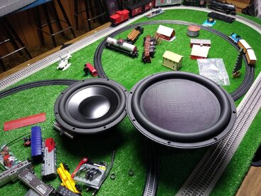

I got the sub. Now I just need some time and good weather. The pic shows the old sub sitting by the new 1. IMG_20210331_192545227.jpg
Started dreaming about the next project. The wife needed to take the book case my center channel was sitting on. I thought this might be a good excuse to build a transmission line box with an Ultimax 18. I have never done a t-line. Any thoughts about any of this?
I got the 15 Ultimax put in the box this weekend. All I can say is WOW. My ceiling tiles were moving. Huge difference considering it is the same box and amp. I highly recommend the ultimax 15 inch subwoofer. Thanks everyone for the advice and information.
