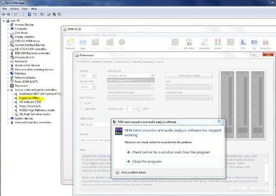

Hello,
I got a cheap old Mbox 1 original (the vertical one) and found the drivers:
http://secure.digidesign.com/services/avid/kb/downloads.cfm?digiArticleId=23087&localeCode=en
V7.4 still has Mbox 1 support
"Digidesign MBox" shows up in the Windows Device Manager (Win 7 64 bit) under "sound, video and game controllers"
It does not show up for playback or recording under Hardware and Sound> Sound> Manage Audio Devices... not sure if it should.
I tried to set this device in REW 5.18 (non beta). Under soundcard>ASIO device, it shows "ASIO Digidesign Driver"
Clicking that crashes REW. Standard windows message: REW has stopped working, check online or close program
:dontknow:
7,310
There might be some info in the REW log files, their location is shown in the About REW box. Could be an issue between the ASIO driver and the dll that makes ASIO available to REW though.

This is all in the log:
Jul 21, 2018 11:04:21 AM roomeqwizard.RoomEQ_Wizard main
INFO: REW V5.18 running JRE 1.8.0_102 32-bit on Windows 7
Jul 21, 2018 11:04:25 AM com.synthbot.jasiohost.AsioDriver <clinit>
INFO: Loaded jasiohost.dll
7,310
Seems like the crash happens as soon as the dll tries to load the driver, so REW doesn't get a chance to capture anything. Could try the latest beta versions to see if the behaviour is any different, but I'm not optimistic.

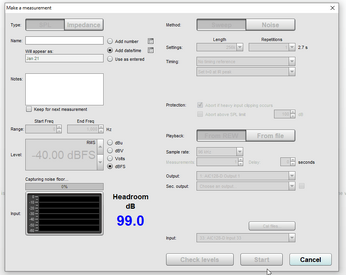

I'm having a similar issue in v5.19. Was this issue solved?
I'm using a Yamaha Dante sound card (AIC128-D) and REW freezes when making a measurement. I guess it's something to do with the ASIO driver..?

Can you post a screenshot of the Measure dialog when measuring? Please also zip and attach the contents of the REW log files folder.

It just freezes at the start of the measurement. I can cancel the measurement but then REW stops responding.

7,310
I'd like all the contents of the REW folder, please, there may be something in the output file. There is a chance it is a Java/AMD Ryzen issue, there are some reports of Java problems on Ryzen. Another Ryzen user had an issue but that turned out to be related to a game controller. Could try the 32-bit build of REW to see if that behaves differently.
7,310
