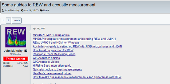

Start be reading through the many self-help articles found within this forum.
Click the pic ( to see the many topics covered ) ;
Guides
