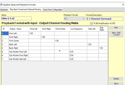

In playback format and channel routing each output/input ID has either a 1.00 or a .50 marked what is that?

Trdat, I believe that you are seeing something similar to what’s in my setup routing. I have three subs in my system. I interpret my setup to route 25% of the total bass signal to my front and side left subs and 50% of the total bass signal to my front right sub, summing together to unity. It sounds you have a similar need on your end. JCR
To be honest I have a few configurations I have to try, one adding an active crossover to my biampes speakers leavng 3 channels for each sub to be measured independantly, or leaving those two channels to make the biamp system purely with audiolense crossovers which would leave only one channel for my subs which would have to have them all summed up.
So for the above configuration you have 3 subs but how many channels? I'm hazarding a guess that you have 3 channels for each sub right? My problem is that if I use 4 channels for the biamp it leaves me with only one channel for all my subs.
One way I suppose is to get another DSP with 6 outs for the subs and put in between the DAC and sub amps.
And the whole .5 and ,25 concept I am trying to get my head around.
