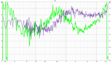

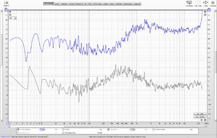

Calculation of the minimum phase.
sm52
Mar 14, 2019
885
I have measured the impulse response of the tweeter in REW. Then I exported this measurement to a text file for the crossover simulation program. VituixCad2. In this program, I drew only a signal source, a wire and one HF speaker. I have generated the minimum phase in REW and in VituixCad2. Which minimum phase graph is more corresponds to reality? I am attaching a measurement file, a .txt file and screenshots of the minimum phase in two programs. In the screenshot of VituixCad2, the minimum phase is green.

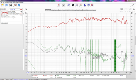

Hello Earl,
It's worth it!
I drew the spl curve with the tools of the vituixcad factory from a curve of my own factory.
Here's what it looks like.
The upper curve is the original REW curve and, of course, the lower one is the VCad curve.
I had noticed that VCad2 was creating phase values without knowing why.
These stories of minimal phase create endless bickering on some French fora.
I was told that measurements had to be made at 88.2 or 96 kHz for REW to calculate the minimum phase properly.
Mine was done at 44.1 kHz last year.

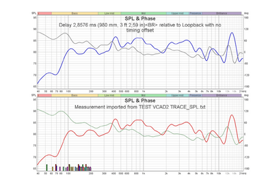

Bernard
May 22, 2017
120
sm52,
I didn't try to find out which software is the best.
Starting from EarlK's remark, my goal was to compare the minimum phase curve generated by REW and the phase generated by the VCAD2 tool from an SPL curve drawing.
We launch REW, open the file, click on the All SPL tab, apply a smoothing, and take a snapshot with the Capture button.
Next, we launch VCad2, choose Tools Trace SPL and open the snapshot we just made with REW. There is a video on Youtube: VituixCAD SPL Trace (1.1.18.1 or later) - YouTube .
We go back to REW and import the text file created by VCad2.
You need to take a snapshot of the minimum phase of the REW mdat file and another snapshot of the phase of the VCad2 txt file in order to be able to compare the two phase curves.
You can see that the curves are very close and that the Trace SPL tool of VCad2 gives good results if the work is done carefully.
The differences must come from the calculation method used by each of the two creators.
The goal is achieved: EarlK's remark is verified. QED.
