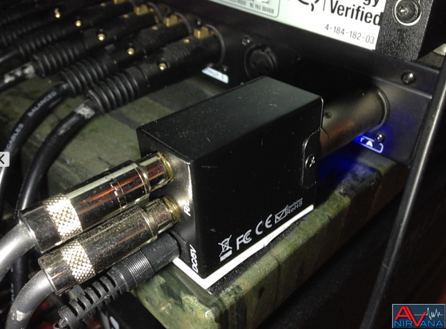

Not sure how a dig to ana convertor helps. As mentioned before... the DCX2496 doesn't have digital inputs.
