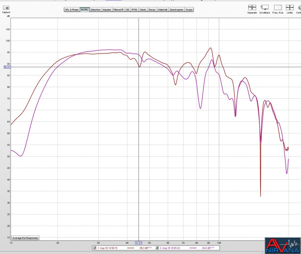

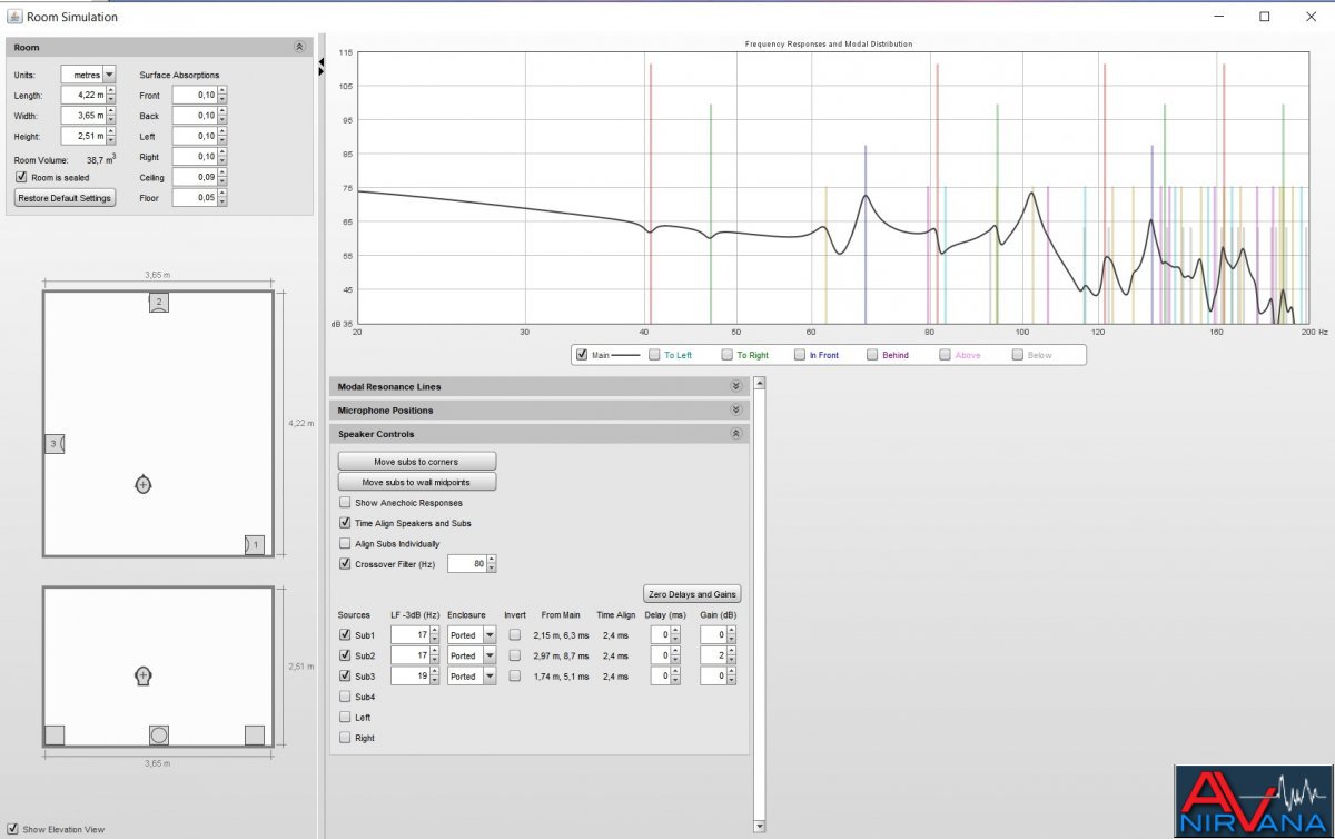

ah ok can you maybe help me ? i have 3 subs and where i must start ? Whats the best way to bring them together ? I use 2 Behringer DEQ 2496 ( one DEQ 2496 for Right Corner and mittle Corner ) and the other DEQ for the back Subwoofer (3 x XTZ 12.17 )
Here is a picture from my room
and this is the best result that i get so far.
is the setup right with the Behringers `? Or i shoud setup DEQ one with Front and Back and the other (middle Sub ) with the other ?

and other question , what i shoud first do ? before i edit so : first delay with volume edit then the peq for the modes for the sum of all subs. Is the line right ? or i shoud do before all room modes eliminate for each sub
7,314
Try this link: Multi-Sub optimizer
If you don't use the multi-sub optimiser approach then best applying EQ for all subs together, i.e. treat them as one sub with the same filters for each. If you have a single subwoofer signal then EQ that one signal before splitting it to the subs.

i have use multi sub optimizer but the endresult was not the same like how in the program. Can you may help me , how i start with 3 Subs ? I have bought me now the mini DSP HD 2x4 , the must came in few days but until there woud i place the back sub maybe in the corner .
The sub 3 (in the picture upstairs ) what is the best position for the 3. sub ? Middle of the wall like right now or in the corner like sub 1 ?
7,314
Best asking in the MSO thread for any support on that. If you will be applying EQ to tackle peaks corner placement for subs can achieve best LF extension, but usually it is necessary to try the various positions available and see what gives a response with the fewest dips.
